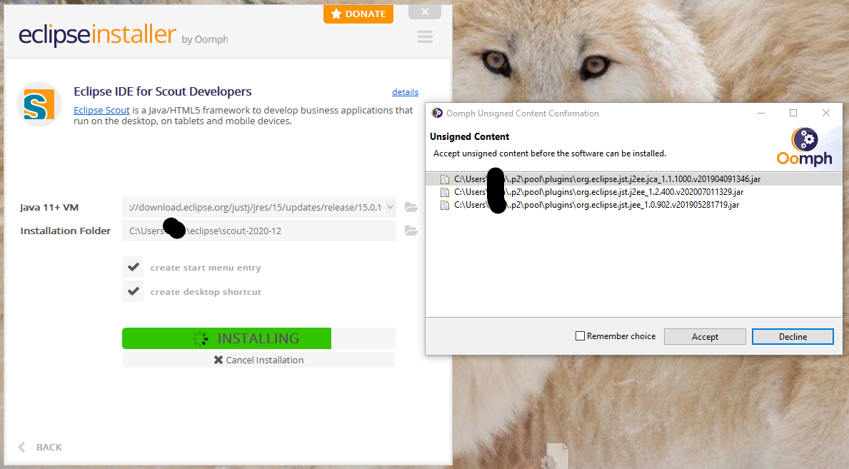

Please see attached image.
Attempting to install the latest Eclipse on Win 10 x64, I select the Scout IDE option from the installer, but before it finishes, it is prompting that some "content" is unsigned.
I think this shouldn't happen. Is it normal? Should I "Accept" them unsigned? Why?

It should not normally happen, but when the developers screw up the builds and don't sign all the jars properly then this happens. I looked in here:
https://download.eclipse.org/justj/?file=releases/2020-12/202012161000/plugins
Indeed those jars appear to be unsigned so in that case, yes, one would unfortunately expect this to happen.
If you don't accept, the install will fail to complete.

I was more inclined to not accept rather than risk having some possibly shady code.
I haven't used Eclipse for years and I am not sure where the installer is downloading the components from, this is why I thought better safe than sorry.
It seems that there's no need to be too much alarmed in this specific case.

No, not a big need to worry. The repository metadata includes checksums as well and those provide security (the downloaded artifact's checksum must match the expected checksum) even if there is no signature.
