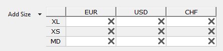

Re: NatTable add header row cell [message #1837159 is a reply to message #1837138] Fri, 22 January 2021 19:06 Go to previous messageGo to next message
Hi Dirk,
Since it would be simpler decorating the single header columns, I considered decorating them. But I realized it works only for body cells, and not for columns headers or row headers.
For instance, with the following configuration:
configRegistry = new ConfigRegistry();
// Register custom painter, paint icons on right
configRegistry.registerConfigAttribute(CellConfigAttributes.CELL_PAINTER,
		new CellPainterDecorator(new TextPainter(), CellEdgeEnum.RIGHT, new ImagePainter(deleteImage)),
		DisplayMode.NORMAL, GridRegion.ROW_HEADER.toString());
		DisplayMode.NORMAL, GridRegion.COLUMN_HEADER.toString());
		DisplayMode.NORMAL, GridRegion.BODY.toString());
// the rest is unchanged ..
I get to see the Decorator only on the Body cells, as in the following image
index.php/fa/39809/0/

Re: NatTable add header row cell [message #1837164 is a reply to message #1837159] Sat, 23 January 2021 01:44 Go to previous message
Interesting that you refer to the stackoverflow and the forum, but it seems you have not found our getting started tutorial
https://www.vogella.com/tutorials/NatTable/article.html
I think the configuration you posted should work. But probably the default configuration of the headers override your configuration. You could try to set your configuration after NatTable#configure() directly on the NatTable ConfigRegistry that you can access via getter. If you see that it works, either create a custom style configuration that replaces the default or even use a theme configuration.
