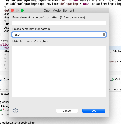

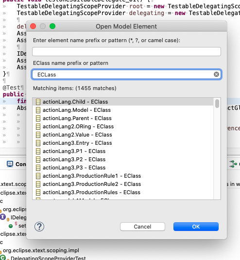

afaik estructural features are not in the index so it wont work with default scoping.
maybe you can try an eclass with QN + a separate reference for the feature.
or you do a reference to an epackage and do scoping for the qualified features manually.
also see open model element dialog
