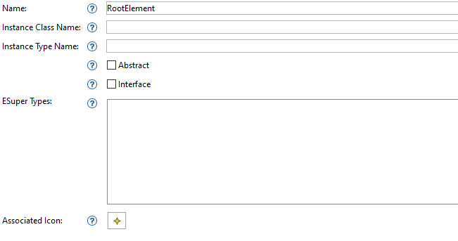

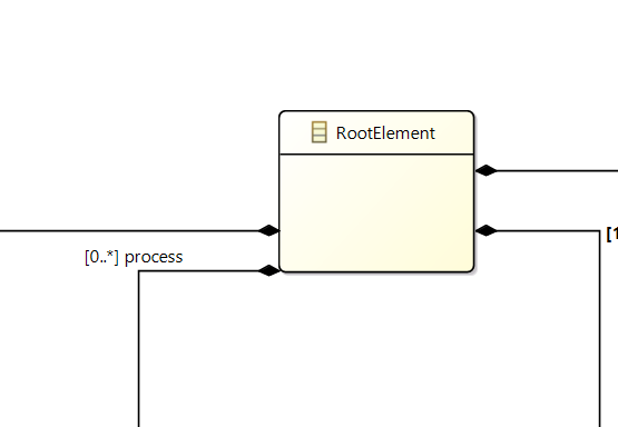

So here's where I might not understand. My RootElement is composed of everything else within my metamodel. In my VSM is it the Domain Class of my Diagram Description.
When I started I assumed that this is the same thing as the RootElement of my metamodel. As such it's typing would also be unique. Is that why I'm getting this warning?

This is how it is defined in my Ecore metamodel. Is there another way that I should be doing this, this was the intuitive approach that I thought was needed to create an editor in Sirius.

Re: the following mapping semantic candidates expression could not be correctly evaluated [message #1837115 is a reply to message #1837065] Fri, 22 January 2021 05:57 Go to previous messageGo to next message
I don't understand your question.
On your DiagramDescription your Domain Class is RootElement. This means that you can create this kind of diagram on a semantic element typed RootElement. Then you have Node/Container/Edge mapping in order to specify the elements that will be displayed on your diagram. The warning that you have tells you that you have a mapping with a semantic candidate expression "feature:RootElement" and this expression is wrong as RootElement is a type, not a feature. If you want to display on a diagram the RootElement (the one you created the diagram on) then the expression would just be "aql:self". If you want to display elements contained by your reference process then the expression would be "feature:process" (I don't know the Domain Class for this mapping as I do not seen what is at the other end of your reference on the screenshot).
Steve
