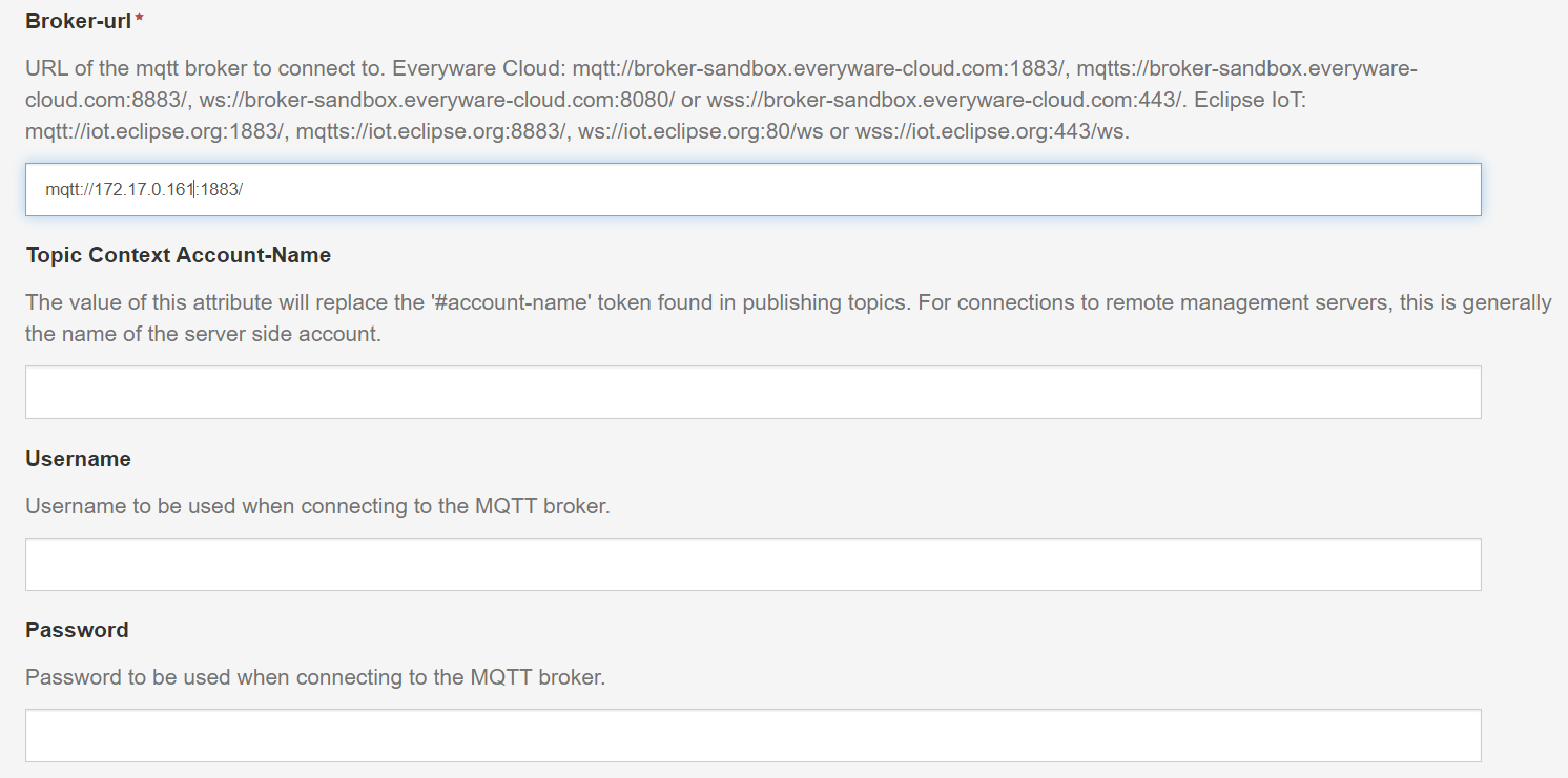

I have found one issue in this forum where someone wanted to run the broker on a pi (https://www.eclipse.org/forums/index.php/t/1078080/). However his problem was, that he ran kura and the broker on the same pi, which is not the case for me. I use the IP of my pasberry, which runs mosquitto mqtt, in the broker url field. The connection fails with a "Failed to connect error!". Using python for a test publish and subscribe, I checked that the broker worked. What else could be the issue?
Any help would be greatly appreciated.
Thanks in advance
Paulina

I added a screenshot of the mqtt config. I pretty much only changed the broker-url and deleted the default entries for Topic Context Account Name, Password and User.
