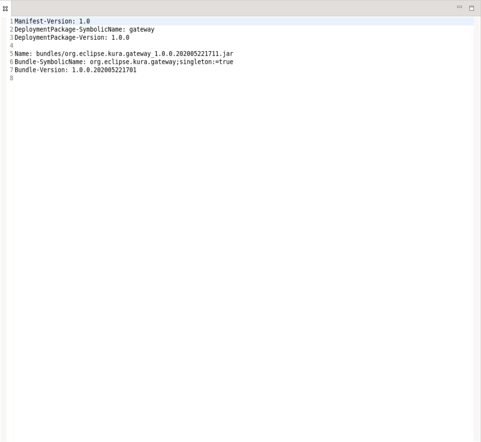

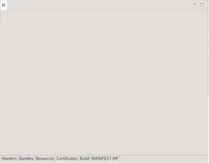

Hi, i've tried to create a dpp file from the kura gateway project, but everytime i create the dpp file it is empty.
Does anyone have a clue why this problem occurs?
It only happens to me, when i am using eclipse ee (the version from december 2020) in my debian environment in virtualbox. I do not have this issue within windows.
In the attachemnts you can see my view of the opened file.

Re: dpp file generated empty [message #1836931 is a reply to message #1836920] Tue, 19 January 2021 03:46 Go to previous messageGo to next message
how did you create the file?
On my Eclipse EE v418 the ddp file creation wizard is missing :-(
Re: dpp file generated empty [message #1836932 is a reply to message #1836931] Tue, 19 January 2021 03:56 Go to previous messageGo to next message
Did you install mtoolkit?
Re: dpp file generated empty [message #1836938 is a reply to message #1836932] Tue, 19 January 2021 06:01 Go to previous messageGo to next message
Yes, but I didn't think that feature depended on that plugin.
I re-installed it and it seems to work.
Thank you so much
PS:
To re-install I used this location http://mtoolkit-neon.s3-website-us-east-1.amazonaws.com Is it ok for last Eclipse or there is an updated version?
Re: dpp file generated empty [message #1836988 is a reply to message #1836938] Wed, 20 January 2021 10:38 Go to previous message
no, that is the latest version of the plugin for Eclipse
Matteo
