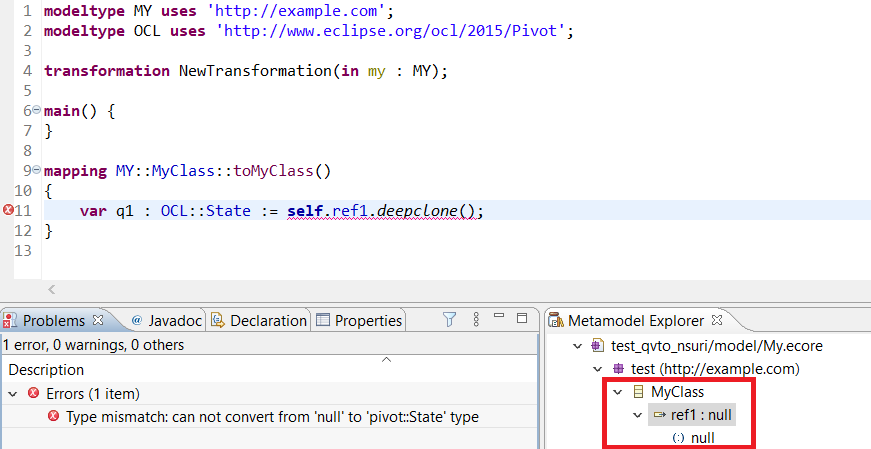

The metamodel refers to another metamodel ( http://www.eclipse.org/ocl/2015/Pivot ). It doesn't matter what model is referred. I have the same problem for any referenced metamodel.
One can run a nested Eclipse instance, open the transformation in QVTo editor. The transformation doesn't have any validation errors.
However if you will open it in the initial Eclipse instance (not the nested one), then you will get the following error:
"Type mismatch: can not convert from 'null' to 'pivot::State' type"
index.php/fa/39739/0/
The problem is that GenModel wizard replaces the following line in the ecore file:
    <eStructuralFeatures xsi:type="ecore:EReference" name="ref1" eType="ecore:EClass http://www.eclipse.org/ocl/2015/Pivot#//State"/>
by this one
    <eStructuralFeatures xsi:type="ecore:EReference" name="ref1" eType="ecore:EClass ../../org.eclipse.ocl.pivot/model/Pivot.ecore#//State"/>
So QVTo is unable to resolve the reference to State class anymore. If one reverts this line, then QVTo works fine again.

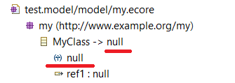

The code is wrong, because I guess that a classes should not be derived from Pivot classes. However, it just demonstrates the problem.
Because of the bug the super type of MY:MyClass is null. And there is no a workaround for such a QVTo mappings.
index.php/fa/39741/0/
I get the error:
"Mapping operation 'my::MyClass::baseMapping' has non-conformant signature for 'inherits' in 'my::MyClass::derivedMapping'"

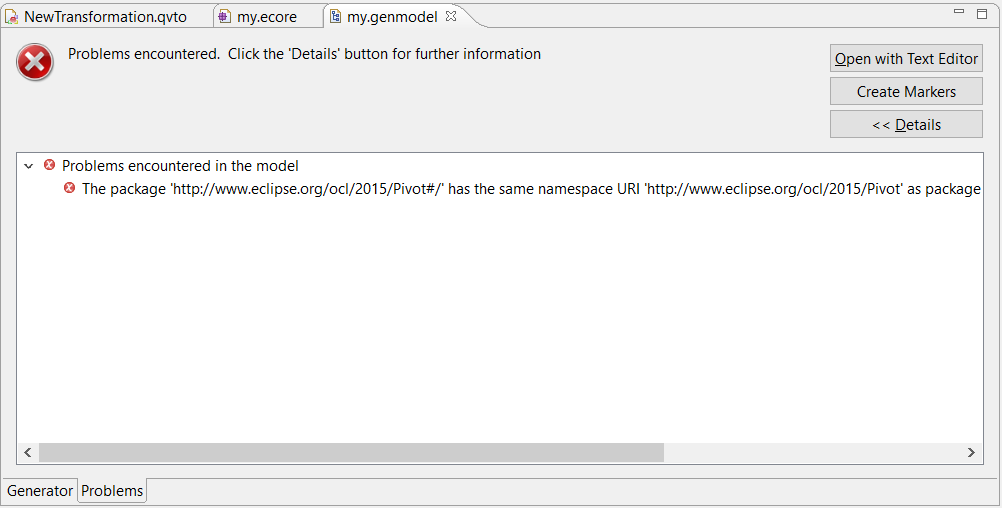

Re: Support of metamodels referencing other metamodels [message #1837016 is a reply to message #1836903] Thu, 21 January 2021 00:06 Go to previous messageGo to next message
I can change URI manually, and it will fix QVTo. However it will break GenModel:
index.php/fa/39764/0/
I get the error:
"The package 'http://www.eclipse.org/ocl/2015/Pivot#/' has the same namespace URI 'http://www.eclipse.org/ocl/2015/Pivot' as package 'platform:/resource/org.eclipse.ocl.pivot/model/Pivot.ecore#P-pivot'"
The problem is that
1) my.genmodel refers to ../../org.eclipse.ocl.pivot/model/Pivot.genmodel
2) Pivot.genmodel refers to Pivot.ecore
3) Pivot.ecore is resolved to platform:/resource/org.eclipse.ocl.pivot/model/Pivot.ecore
4) However my.ecore refers to http://www.eclipse.org/ocl/2015/Pivot
5) As a result 3 and 4 confilcts
So it seems that the only right way to refer ecore-files is to use a relative URIs like ../../org.eclipse.ocl.pivot/model/Pivot.ecore
I guess that QVTo should be able to resolve such a relative URIs.
