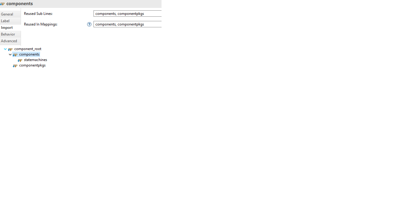

I tested (see sample in attachment) with EPackage/Eclass to reproduce the idea. On my EPackage linemapping, for the "Reused sub line" field, I added the EPackage linemapping and then the EClass linemapping. On my table, sub levels are displayed with EPackage first and EClass afterward.
Does this answer your issue or I missed something?

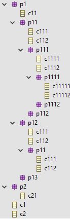

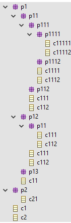

I replied too quickly, what I meant is, if I add the mapping on EClass, before the mapping on EPackage, then I do have the EClasses displayed first.
EPackage first:
index.php/fa/39803/0/
EClass first:
index.php/fa/39802/0/
I only used the "Reused Sub Lines" field, not the Reusing in Mappings one (But adding the mapping on EPackage to "Reused Sub Lines"did also add it to "Reused in Mappings".
Steve
