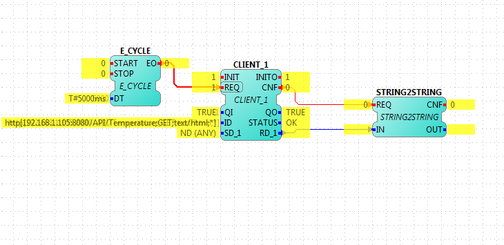

I am trying to get a response from a HTTP request. I am using FORTE 1.10.3 this is the error that I am getting:
INFO: T#0: FORTE is up and running
INFO: T#0: Using default bootfile location: forte.fboot
INFO: T#1: Boot file forte.fboot could not be opened. Skipping...
INFO: T#2347: Connection closed by peer
INFO: T#41767: [HTTP Layer] FB with GET request initialized. Host: 192.168.1.105, Path: API/Temperature
INFO: T#48596: CBSDSocketInterface: Opening TCP-Client connection at: 192.168.1.105:8080
INFO: T#48603: [HTTP Handler]: Starting HTTP timeout thread
DEBUG: T#49664: [HTTP Layer] Handling received HTTP response
ERROR: T#49666: [HTTP Layer] Invalid or incomplete HTTP response
ERROR: T#49666: [HTTP Layer] FB with host: 192.168.1.105:8080 couldn't handle the HTTP response
My server is responding a temperature like 25.5 using text/html.
I would like to know what is the response type that the FB is waiting?

I am using 1.13 and http client works fine for me.
I think you can debug the code to see why the response does not work. Or maybe you can get the traffic in wireshark and see if the reponse is not standard compliant.
Why not update to 1.13?
