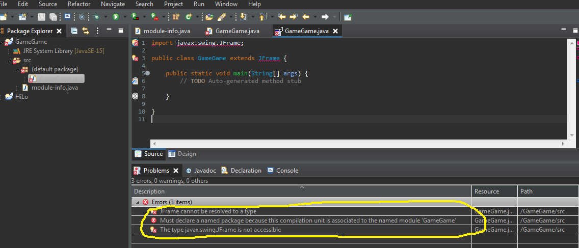

Hello. I am sorry for my English. I am beginner. Eclipse for Java. 2020-12 (4.18.0)
My starting project. Problems with the WindowBuilder and JFrame. Please help me!
Sourse:
import javax.swing.JFrame;
public class GameGame extends JFrame {
// TODO Auto-generated method stub
Design:
The parser parsed the compilation unit, but can't identify any GUI toolkit.
Possible reasons:
•You open a compilation unit without any GUI, such as an empty class, data bean, etc.
•Classpath of project is not valid, does not include all required toolkit libraries.
•You attempt to open UI for toolkit, support for which is not installed in WindowBuilder.
Use button Show UI Toolkits to install new toolkit.
Besides three errors, on screenshot,
Thank you.
  • Attachment: question.png
    (Size: 66.46KB, Downloaded 193 times)

There was the same problem. I read it here https://www.eclipse.org/forums/index.php/t/1099348/??SQ=d56690606bbc2058babed5a12559d6de&S=677cab6f7df3235ce6c19421f3132c59
Here is the solution
just changed the module-info.java to contain:
 module NAME-MUDULE {
	requires java.desktop;
Re: Window Builder. HELP ME! [message #1836626 is a reply to message #1836625] Sun, 10 January 2021 00:12 Go to previous message
Thank you!!! I did it.
