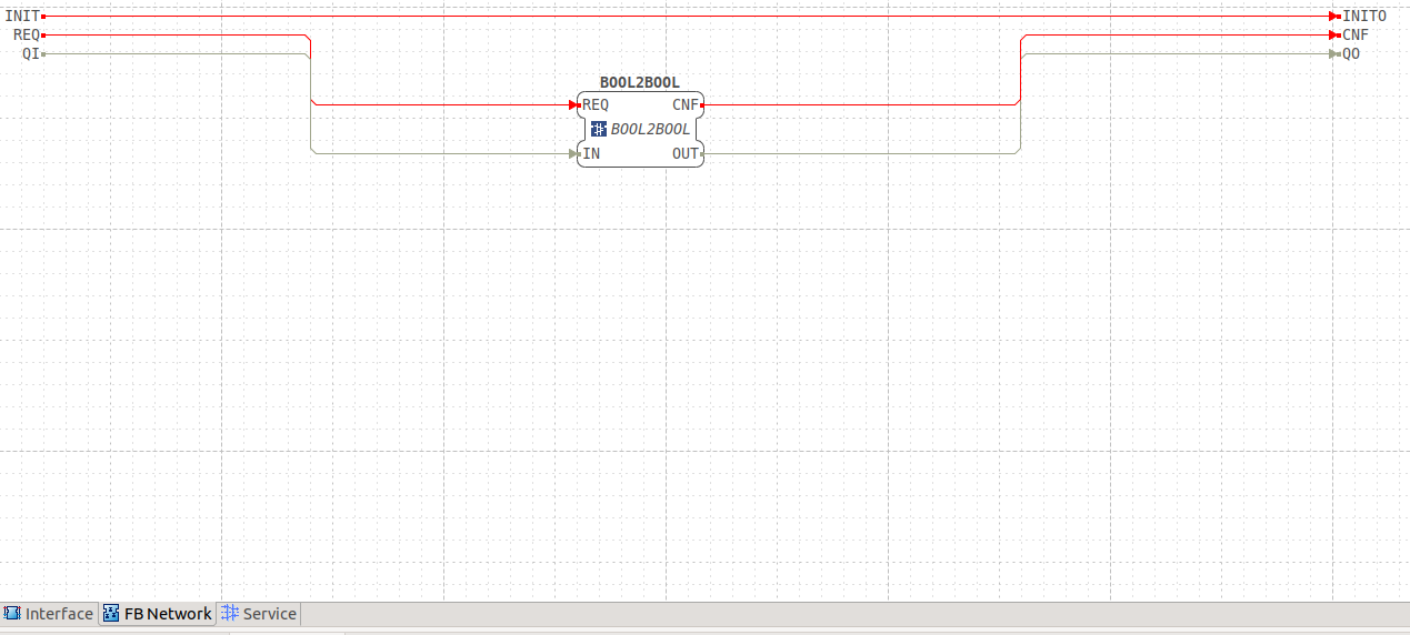

when I use typed subapplications and deploy the system I am unable to watch (debug watch) the functionblocks inside the typed subapplication. A double click on the typed subapp in the main app brings me to the detail view (see detail-view-subapp.png) while a double click on a untyped subapp or composite functionblock gives me the the possibility to watch the blocks in the inside.
As a workaround I could detach the subapps from their type every time I want to watch the blocks in the inside. But since this takes much time I want ask whether there is another workaround or whether typed subapps could get the same behavior as cfbs or untyped subapps regarding watching in debug mode.

Unfortunately, watching of typed subapps is currently not yet working. For that we need first a viewer for the subapp contents similar to the CFB viewer that you used for CFB watching.
