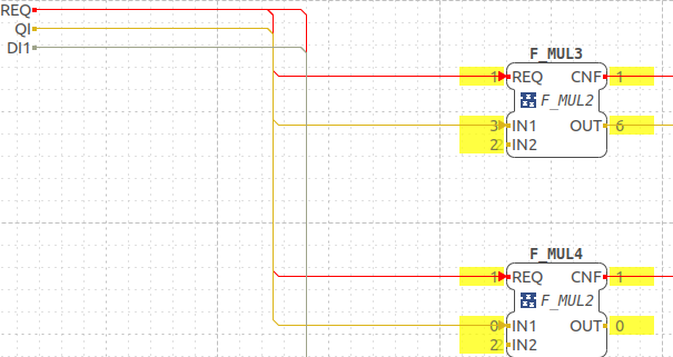

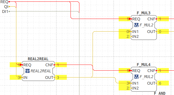

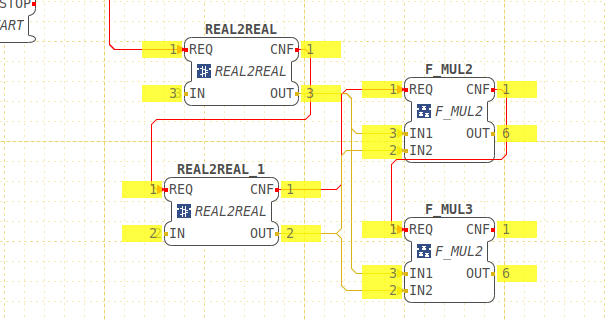

When I try to use any kind of fan-out inside composite blocks, the second line seems to not be realized (see picture no-fan-out1.png and no-fan-out2.png, block interface in block-interface.png). I would expect that the real value of QI could be distributed to F_MUL3 and F_MUL4 as well. This was the case in the version 1.11.3 with which we have worked previously. Using fan-outs in the regular system (not in composite blocks) still seems to work fine (see fan-out-working.png).
Therefore, I want to ask whether I my structure in the composite block is wrong or this is a bug in the current 4diac 1.13.0 version.

unfortunately it seems that we have a bug in the new code exporter used in 4diac IDE 1.13.0. This was already pointed out in this [1] forum post. However we where to busy and hand yet time to fix it. In order to support us it would be great if you could file a bug in our Bugzilla. I hope to have a look on it in the next days.

Thanks for pointing that out. I now remember that I thought I fixed that already. I will reopen the bug and look into it. I hope it is only a small issue. As workaround for you, you could try typed or untyped subapplications. These you don't have to compile.
Re: Fan-Out not working inside composite blocks in 4diac 1.13 [message #1836449 is a reply to message #1836445] Mon, 04 January 2021 10:14 Go to previous messageGo to next message
I found some time today to look into the problem. And I have to apologize for a very dumb copy paste error. In this commit [1] it should be fixed. Happy for any feedback.
