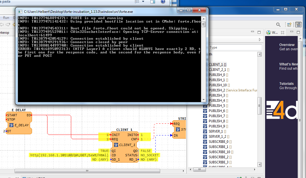

I am trying to use the 4DIAC with HTTP, I compiled the FORTE using the toturial, however the client only have one RD and an error appers as in the figure.
How can I solve that?
Thanks.

Hi, as the error message is stating you need a Client with exactly 2 RD_S. For that you can use a CLIENT_1_2 FB for example. Also please have a look in the documentation on which data types the SD and RDs have to be connected to. Otherwise you may also get errors.

Thank you so much Alois, I made a copy and create a new FB with two RDs. It is working.
