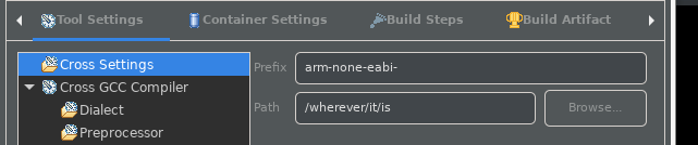

Eclipse didn't add the /sh -- make did.
It's the default shell used by make
and it can't find arm-none-eabi-gcc
Here's an exampleInvoking: GCC C++ Compiler
g++-bad -std=c++17 -O0 -g3 -Wall -c -fmessage-length=0 -MMD -MP -MF"src/TestIncludes.d" -MT"src/TestIncludes.o" -o "src/TestIncludes.o" "../src/TestIncludes.cpp"
/bin/sh: g++-bad: command not found
make: *** [src/subdir.mk:20: src/TestIncludes.o] Error 127
You should avoid using relative paths for things like compilers.
The path will be relative to the current directory when running make.
It may not be what you expect.
Try setting the compiler command path in the Cross Compile settings if you are using an Eclipse Managed Build. Otherwise, fix your makefile.
