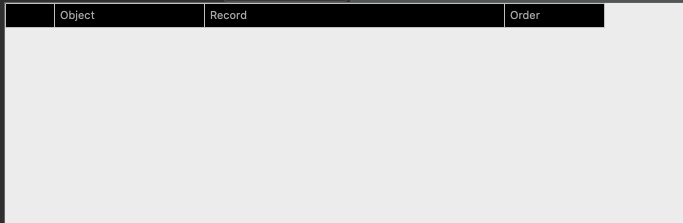

We are using Nattable dark theme. It works good but there is a patch at the end of the row or column if we don't have any rows or not enough columns.
That area (not sure what you call that area) is not themed for Dark and it shows as white patch.
Any idea how to style it so it gets the default widget bg color?

That is because of the background color of the NatTable instance. That is not controlled via NatTable styling. You need to set the background color via SWT mechanism NatTable#setBackground()

Thank you Dirk, it's working great.
Curious about design thought on why it was not set when we assigned the dark theme?

Your answer was clear but I was assuming that it should have been set by theme manager. But I see what you mean that it is not styling but background is not part of Nattable.
