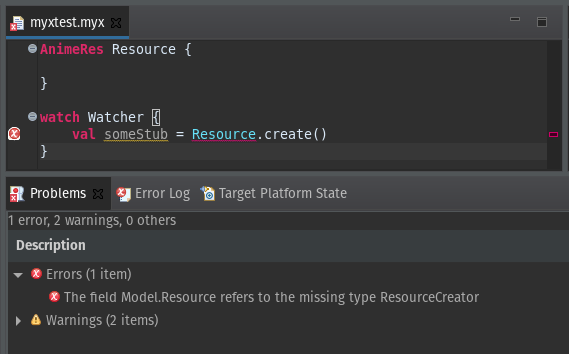

The problem that I've faced with this approach is shown in the attached screenshot index.php/fa/39535/0/
So it seems that some linking fails but I can not understand what I should do to fix that and what bindings I should override and how.

can you please provide a jvmmodelinferrer that actually compiles
