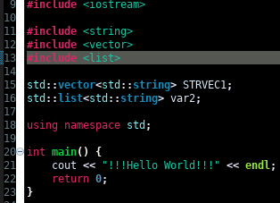

  • Are the the includes flagged like the #include<NOSUCH> below?
    index.php/fa/39538/0/

It's odd that std::list<std::string> var2 works for you without including <list>
Is the code you've posted the actual code with the problem?
index.php/fa/39541/0/
FWIW: Here's a complete program (not cross compiled)
index.php/fa/39542/0/
