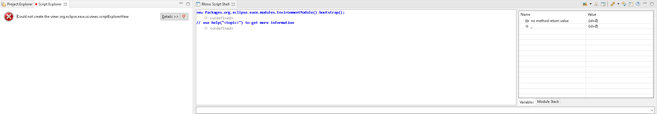

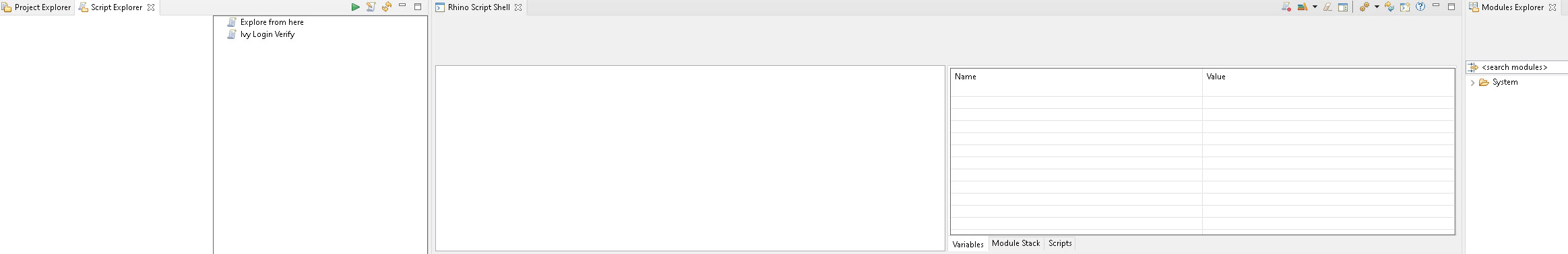

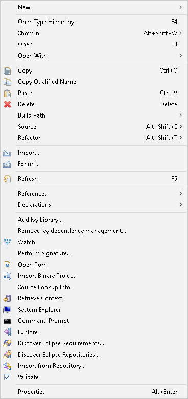

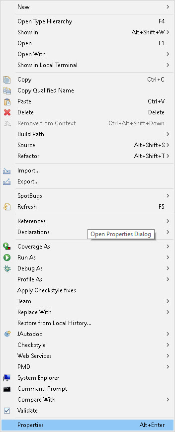

I've installed EASE from the Marketplace into Eclipse 2020-12 and it seems once it is there it takes over the context menus in my default perspective. The Scripting perspective also has a broken shell. If I remove just the UI Components feature it fixes my context menus and the shell but then I can't use the UI features. I'm not sure if this is a 2020-12 issue or another conflict.

Wrong Context menu:
index.php/fa/39510/0/
Correct Context menu (Team/etc):
index.php/fa/39512/0/
Broken Shell (with UI feature installed):
index.php/fa/39511/0/
Working Shell but broken script explorer (UI feature removed):
index.php/fa/39513/0/

Could you please open a bug for this? Currently my time is limited, but the problem seems to be serious, so I would not want to forget about it. As you quite likely do get some Exceptions thrown, please add the stacktraces to the bug.
Re: EASE UI module takes over context menus? [message #1835898 is a reply to message #1835849] Wed, 16 December 2020 00:00 Go to previous message
Sure, I'll go back and dig in the log but I don't recall seeing any exception dialogs when it was broken.
