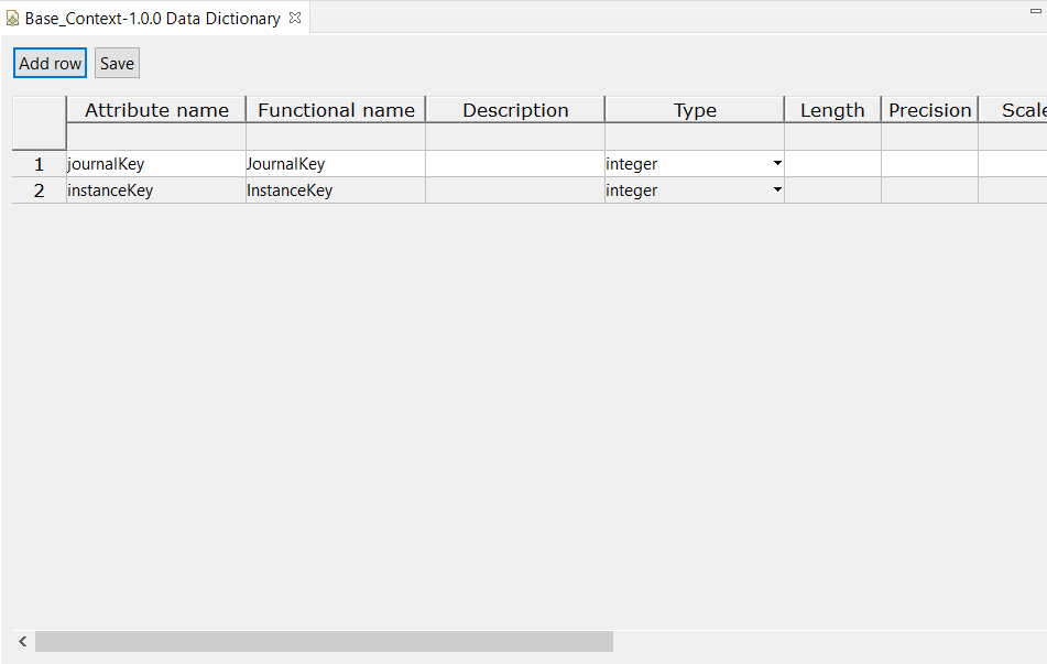

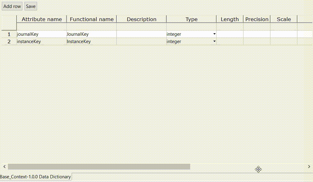

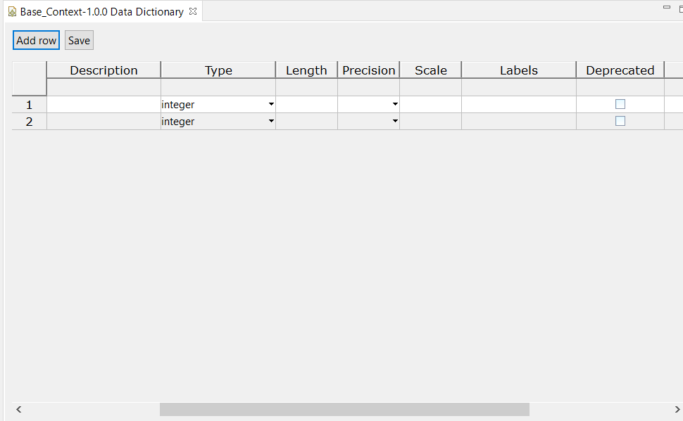

I'm facing an issue when scrolling horizontally in a custom table.
In the first picture attached, the 'Type' column of the table holds a combobox, but after scrolling horizontally, the combobox is also 'moved' to the columns from the right (the second picture attached). So, while I'm scrolling, the combo keeps 'moving' left/right (the gif attached).

Typical issue that the label accumulator is registered on the body layer stack. Register it on the body DataLayer

In the first snippet you register the label accumulator on the stack. Maybe you forgot to remove that.

Ohhhh, you're right. I feel so stupid. :)
Well, this was embarrassing. Thank you for your sharp eyes. :)
