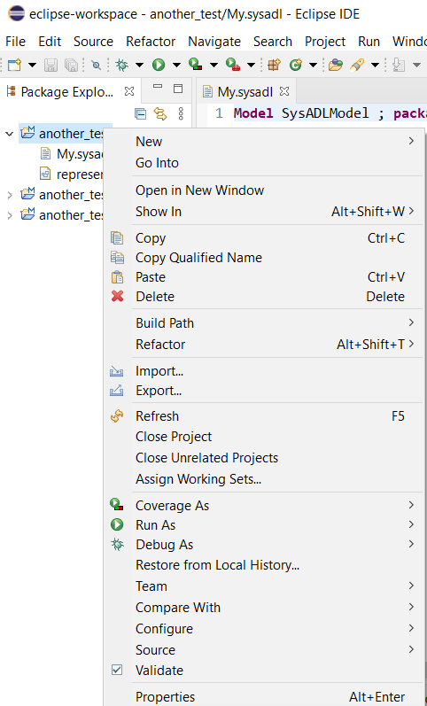

I've successfully installed the SysADL plug in as instructed on their website.

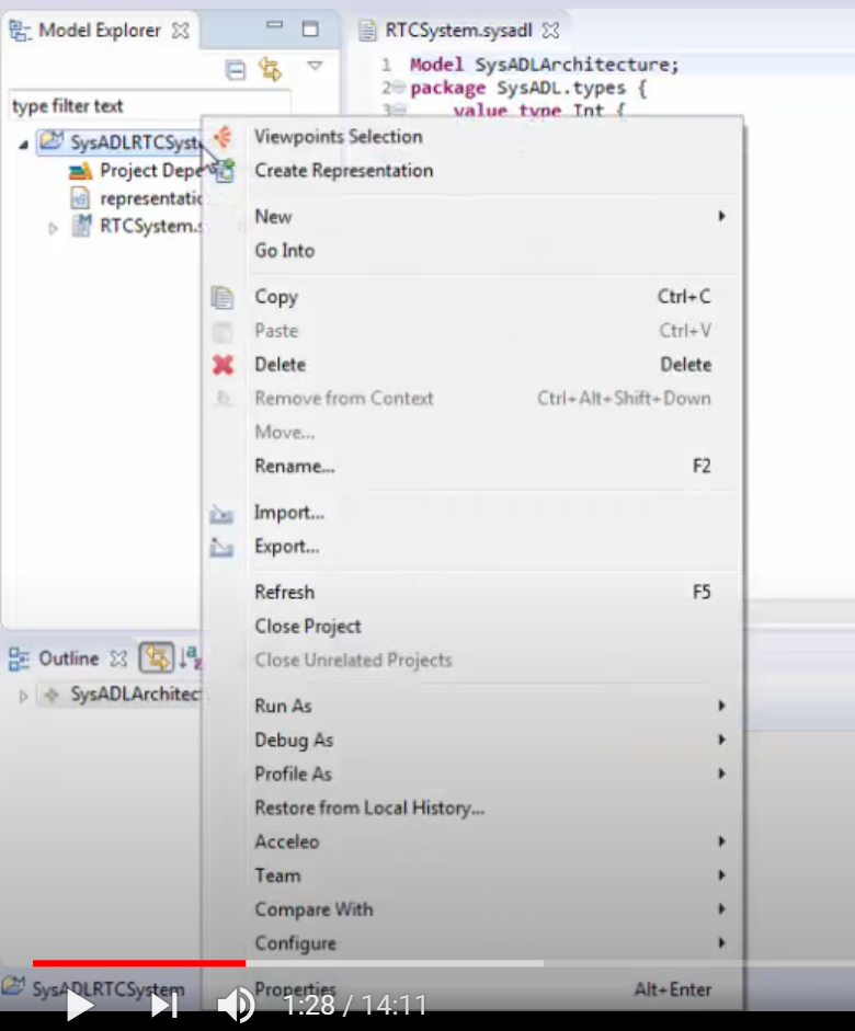

However, after following a video tutorial, I noticed that when I right click on my project, there is no option "Viewpoints Selection", as displayed on the video.
I've tried re-adding the plugin and re-installing Eclipse but the problem still persists.
My Eclipse version is:
Eclipse IDE for Java Developers Version: 2020-09 (4.17.0)
On 'Current.png' it shows how it is currently displayed.
On 'Desired.png' it shows how it should be.

Re: 'Viewpoints selection' option not displayed on right click [message #1835483 is a reply to message #1835330] Fri, 04 December 2020 04:58 Go to previous message
It looks like the Sirius session is not opened (I don't see the "Project dependencies" element) or the semantic resource is not attached. If you double click on the representation.aird file, it will open the session and display the Aird Editor. Can you check if, in the "Models" area, you can see your semantic model? If not you can add it with the "Add" button.
