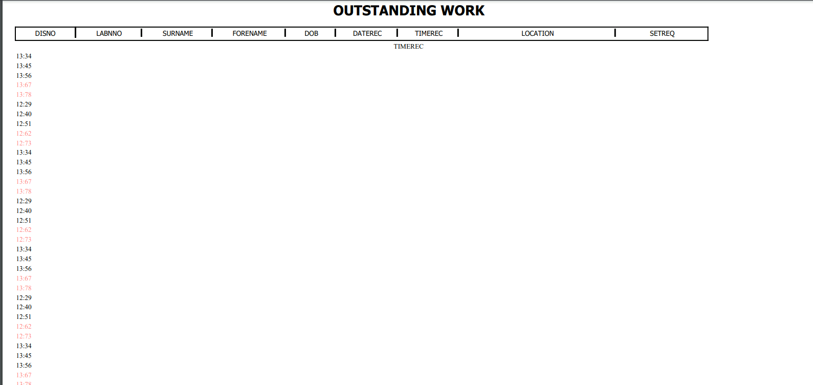

Re: Conditional formatting [message #1835300 is a reply to message #1835284] Mon, 30 November 2020 07:35 Go to previous messageGo to next message
I have attached the design, I have tried to use the highlights feature but that hasn't worked. If in the TIMEREC field the data is coming in as e.g. 12:34
What I am looking for if the Time is : -
less than 30 Mins to be orange
Greater than 60 Mins to be red
Thanks in advance

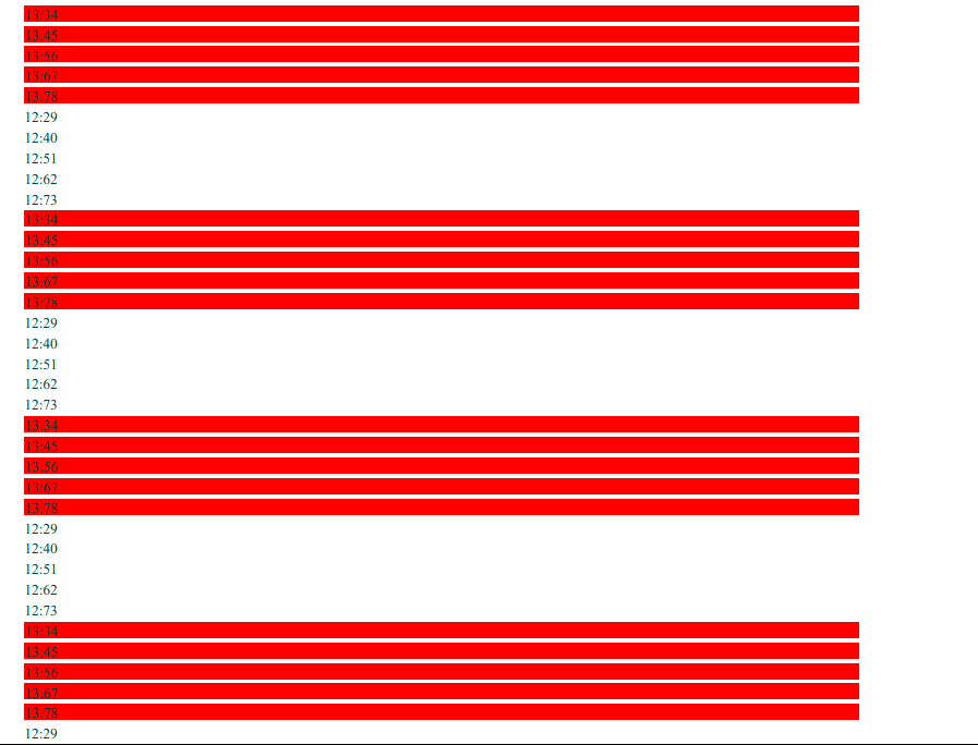

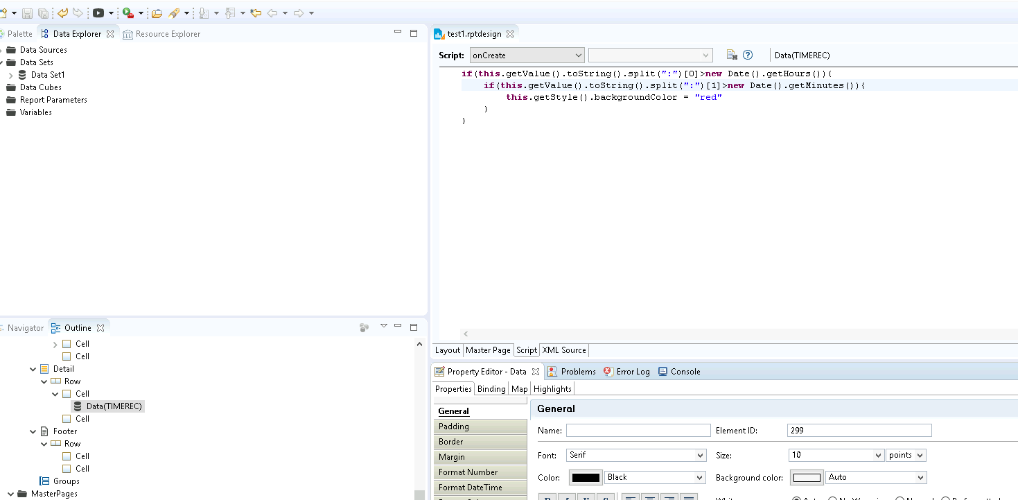

Re: Conditional formatting [message #1835344 is a reply to message #1835341] Tue, 01 December 2020 04:18 Go to previous messageGo to next message
Hey. hope this helps. be careful, I change the background based on the current time. the report constantly checks the time every time a new date is created. if you need to use a date when the report is run, then create it once and put it in a variable
Re: Conditional formatting [message #1835345 is a reply to message #1835344] Tue, 01 December 2020 04:46 Go to previous messageGo to next message
Hey thanks for helping me with this, but i have put that script in and comes up with an error.
can you give me the example reportdesign.
Also you have said red back ground, but after 30 mins it should be orange?

Re: Conditional formatting [message #1835354 is a reply to message #1835347] Tue, 01 December 2020 07:34 Go to previous messageGo to next message
I seem to get the error below : -
I am connecting to a mySQL database.
org.eclipse.birt.report.engine.api.EngineException: Invalid javascript expression: TypeError: Cannot find function split in object Tue Dec 01 2020 12:32:33 GMT-0000 (GMT). (#1)
