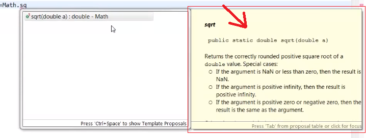

This is the screen that I can't see in the latest version:
(I attach a picture to show the screen)

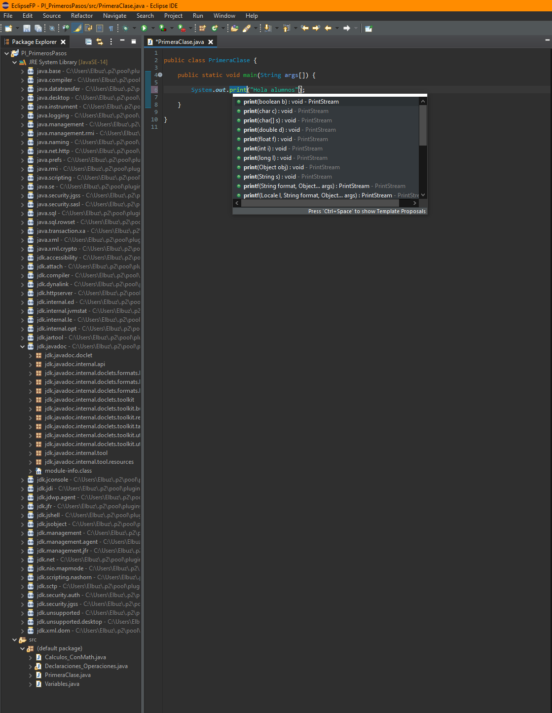

On the other hand, I have looked for the folder you mention to me and yes, I have it:
PI_NumerosPasos \ JRESystemLibrary \ jdk.javadoc
I attach an image so you can see what I get. I hope that this way you can solve your doubt.
Re: I have a problem with the intellisense screen and I can't localize solution [message #1835046 is a reply to message #1835037] Mon, 23 November 2020 18:20 Go to previous messageGo to next message
Those are actually modules and packages for supporting the generation of Javadoc, not actual reference Javadoc. It looks like you'll need to 1) Install an actual JDK from somewhere like adoptopenjdk.net , 2) add the newly installed JDK to your Installed JREs preference page, and 3) right-click on that node and choose that JDK instead of the the current value, which looks like the one provided to run Eclipse itself.

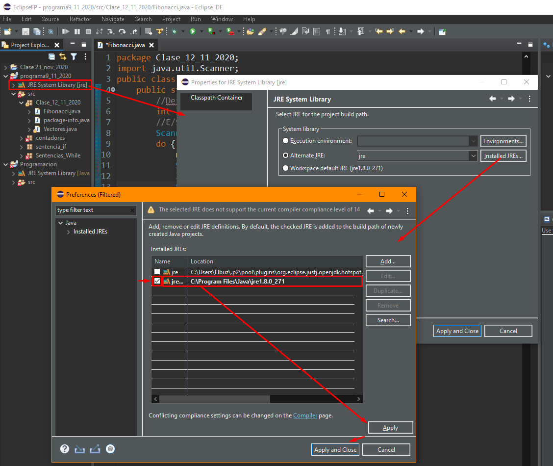

1.) READY. (I downloaded the JDK from the website you recommended.)
2.) READY (I understand this page is "Properties" of the JRE system library in the Eclipse project explorer).
3.) READY (I also changed the JRE, installed https://www.java.com/es/download/manual.jsp JRE
But the problem is not solved :(
I attach an image of steps 2 and 3.
