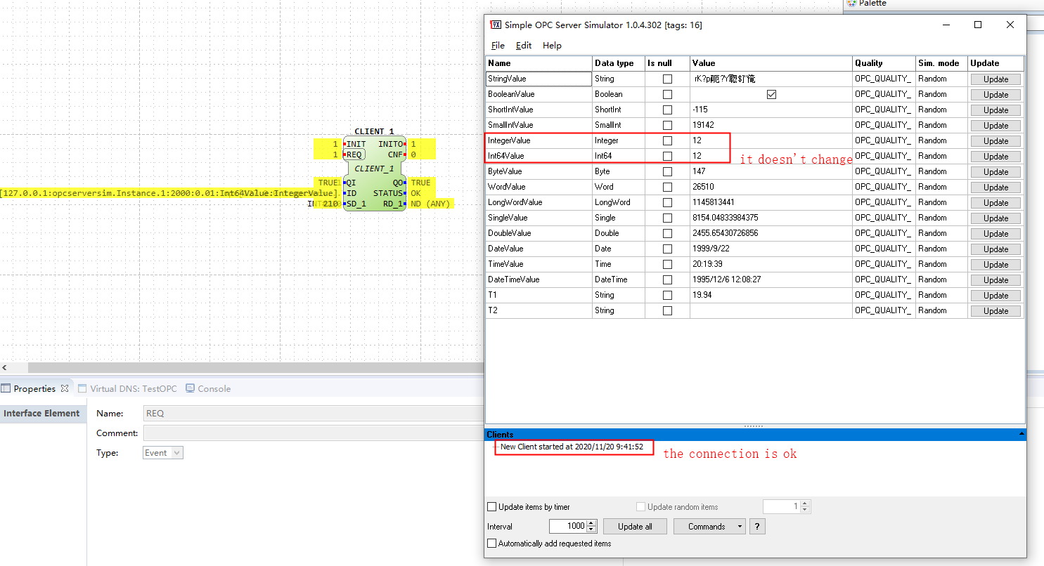

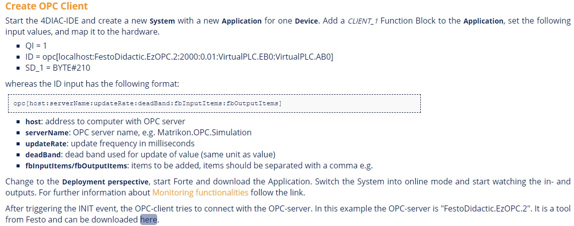

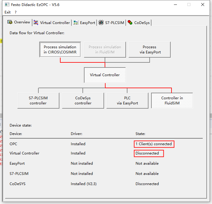

Thank you for your replay. I do a demo according to the document. After triggering the INIT event, the OPC-client connected with the OPC-server. But when I trigger the REQ event to send the data from client to server, it doesn't work. The Virtual Controller state is still disconnected.
I want to read or write data to a opc da server, so I do the second test. I use Simple OPC Server Simulator as my local opc da server. When I trigger INIT event, the connection is ok. After triggering the REQ event, it seems nothing happened.
ID input is opc[127.0.0.1:opcserversim.Instance.1:2000:0.01:Int64Value:IntegerValue]
  • Attachment: EzOPC.png
    (Size: 28.31KB, Downloaded 98 times)
  • Attachment: Test.png
    (Size: 72.65KB, Downloaded 107 times)
Re: How to subscribe or publish with OPC DA? [message #1834903 is a reply to message #1834897] Fri, 20 November 2020 02:34 Go to previous messageGo to next message
I must confess I've never used the OPC DA client myself. We nowadays mostly use OPC UA. However I see one problem that your output RD_1 is not connected. This leaves the output as ANY and therefore the code in the background does not know what to do. Furthermore I see that your input tag has 64 in it but you configured an INT value as input which is 16 bit. Can this be a problem?

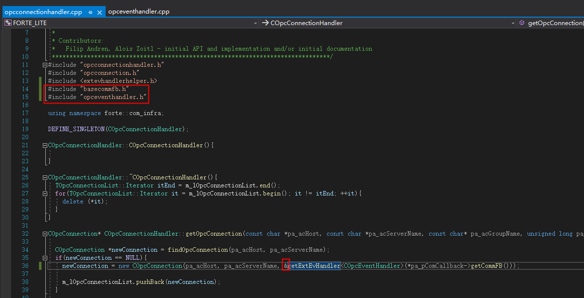

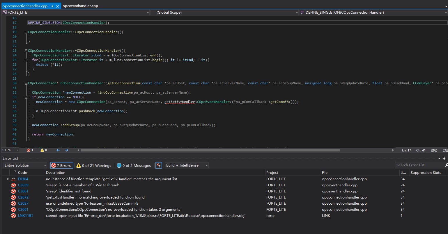

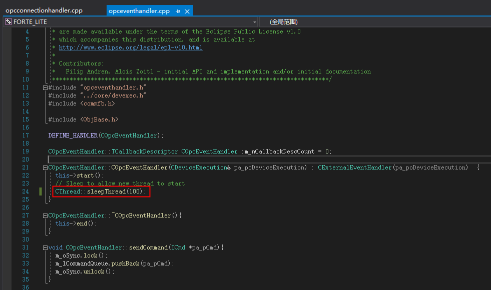

I tried it the way you said, but the result is the same. When I build the FORTE, there are some errors. The attachment is the source code I modified. Did I do something wrong?
Re: How to subscribe or publish with OPC DA? [message #1835308 is a reply to message #1834935] Mon, 30 November 2020 09:29 Go to previous messageGo to next message
Sorry for the late reply. The changes seem correct for me. Wold you mind contributing them back? A description how this can be done can be found here: https://www.eclipse.org/4diac/en_help.php?helppage=html/development/contributeToForte.html

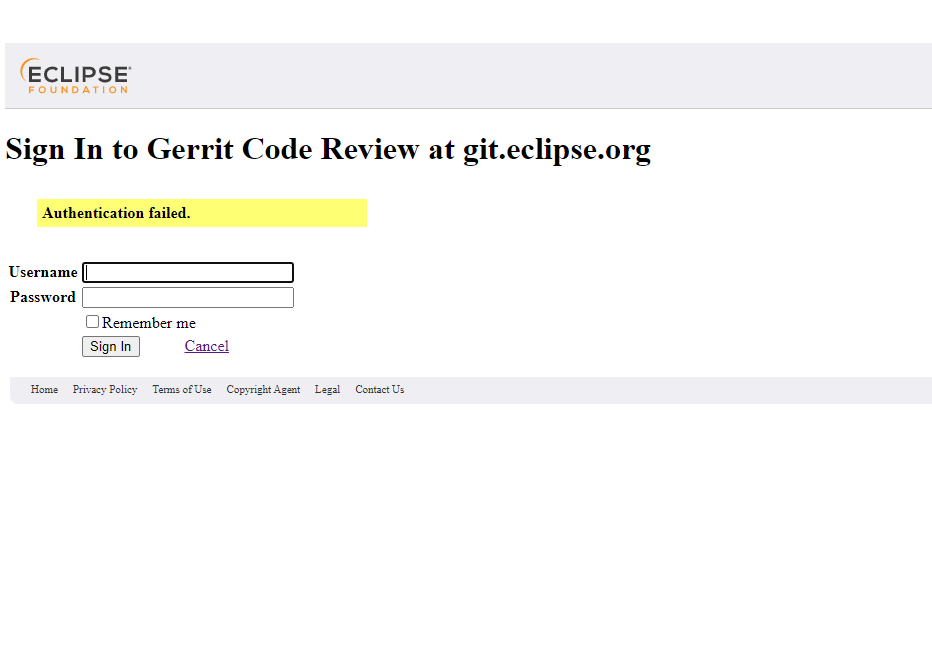

Re: How to subscribe or publish with OPC DA? [message #1836096 is a reply to message #1836062] Sun, 20 December 2020 19:25 Go to previous messageGo to next message
We haven't made that far to upload public key to gerrit as we cannot login to gerrit webpage. You can see the error in the attchment. We think the login information should be correct as it works for forum and Bugzilla.

Re: How to subscribe or publish with OPC DA? [message #1836099 is a reply to message #1836096] Mon, 21 December 2020 02:32 Go to previous messageGo to next message
Oh, yes I forgot about that. I think than the writting to the bug report is exactly what you needed to do. I hope we get this sort out soon.
