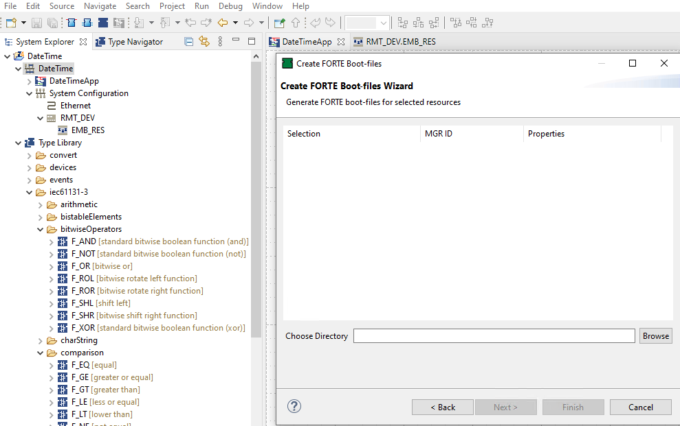

  • Export fboot window is blank and export is not possible
Here is an example of the export to fboot:
index.php/fa/39318/0/
We just recently noticed that we broke this: https://bugs.eclipse.org/bugs/show_bug.cgi?id=568326
Working on it to get it fixed soon.

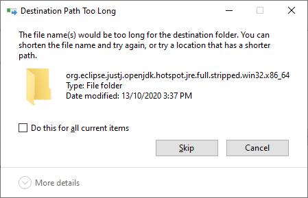

Unpack the ide zip file. The following message is displayed and I click skip:
index.php/fa/39327/0/

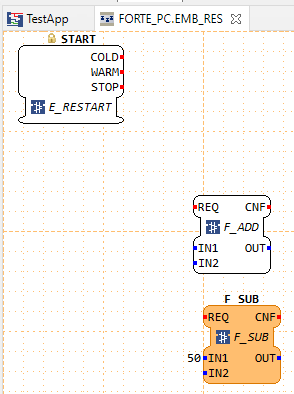

Open the EMB_RES and there is the one mapped FB that worked and also a stray function block. The mapped FB can be unmapped. The stray FB needs to be deleted, it can't be unmapped.
index.php/fa/39325/0/

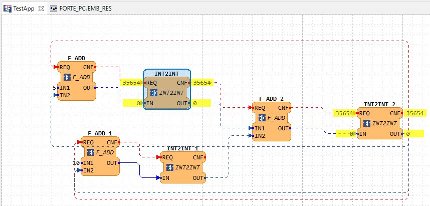

This time the mapping was successful. Some of the linework shows as dashed when it should be a solid line.
index.php/fa/39328/0/

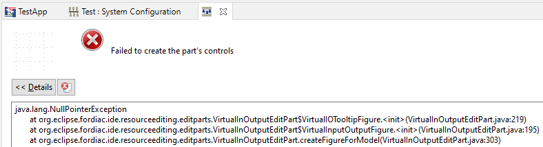

When I open EMB_RES, there is an exception fault.
index.php/fa/39329/0/

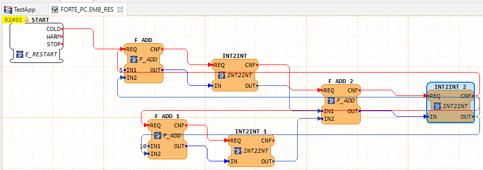

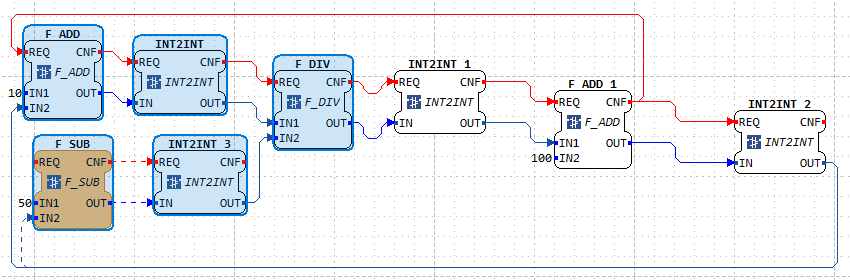

Ok, I managed to get past the last issue. This issue is to do with 'monitor' behaviour. These are the steps I took:
  • Continue from last test (previous post)
  • Unmap all
  • ctrl-a in App tab to select all FB's and map to EMB_RES
  • Open EMB_RES, mapping worked
  • Enable disable monitoring on EMB_RES tab a few times, add and remove watch from various FB's
  • Switch to application tab, no watches are available (which are enabled on EMB_RES tab)
  • Enable watches on FB in App tab that already has a watch enabled on EMB_RES tab
  • Switch to EMB_RES tab, the watch on the EMB_RES tab is frozen
  • Clear all watches on all tabs
  • Disable and enable monitor
  • Switch to App tab, enable monitor and watch on FB's
  • Switch to EMB_RES tab to see remnants from App tab

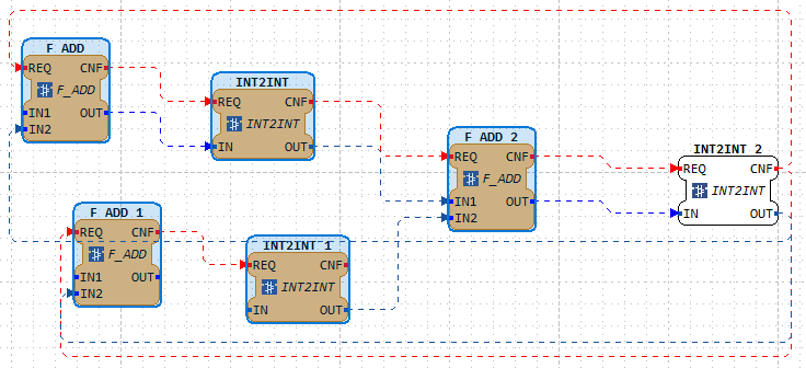

This is the App tab showing the watched. The linework is dashed but should be solid.
index.php/fa/39332/0/
This is the EMB_RES tab showing remnants from App tab.
index.php/fa/39333/0/
Latest .log file attached, looks like it might have a few more exception faults?
If I come across any other examples, I'll post them here.

Wow. thanks for the detailed feedback. I must say the forum is not a very good place to handle so many different things in one place. But I'll try to answer a view things.
First of all thanks for the log files these help a lot to narrow down your issues.
Regarding the path issue. This is a general Windows problem which we can do very little about it.
One mapping issue has already been fixed and will be available in the upcoming 1.13.1 release. We still have to look into the issue that connections are not drawn correctly all the time. This seems to happen only on Windows machines.
The monitoring thingy will be a bigger thing to look into. There we have some major changes in the internal data structures that have to be rethought.
