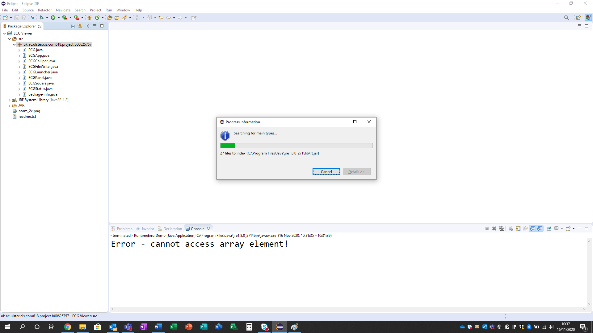

I'm having a strange problem with Eclipse. I say that it's strange because it only happens on my work laptop, not on any of the work desktops. For context, I'm teaching Java as part of a college course, but at the moment we're doing online only delivery for obvious reasons. If I was doing on-campus delivery I'd have no problems with running Java applications on Eclipse on any of the computers on campus, but when I try to use my work laptop (which HAS been issued by the college and is on their domain) I get this problem, EVERY TIME.
The problem is that when I try to run a program I get a message that says "Searching for main types..." and Eclipse starts indexing the files in the JRE folder (in Program Files). It ALWAYS takes AGES to do this, and it does it EVERY TIME I run a new Java application (i.e. a new project I've just created, or one I have imported).
(You can see the error message in the attached image file).
index.php/fa/39314/0/
Is there anything I can do to stop this happening? I've tried clearing out the Eclipse workspace and recreating it. I've tried opening a Java application first thing of the day and running it just so that the indexing will complete - but this doesn't work because as soon as I create a new project or import one I get the same problem.
I'm getting desperate because it usually happens during classes - which slows things down and confuses the students! Any suggestions would be welcome, especially as I've asked on other forums and haven't had any help.

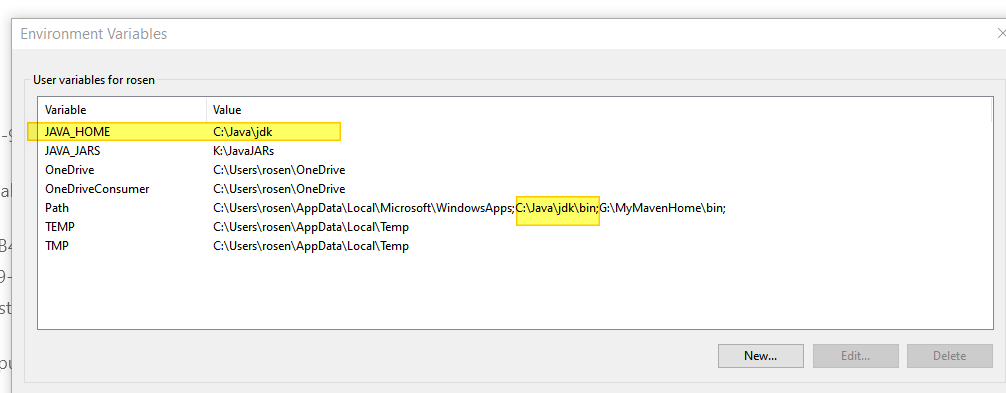

In my case to install :
I created G:\MyEclipse and C:\Java.
eclipse-java-2020-09-R-win32-x86_64.zip unzipped into G:\MyEclipse, So I have eclipse in G:\MyEclipse\eclipse.
openjdk-15.0.1_windows-x64_bin.zip unzipped into C:\Java , the result is C:\Java\jdk-15.0.1 (For simplicity I rename jdk-15.0.1 to jdk)
I set environment variables :
Set "JAVA_HOME" to C:\Java\jdk
Add to "Path" C:\Java\jdk\bin
index.php/fa/39336/0/
Re: Eclipse Constantly "Searching for Main Types" when trying to run Java applications! [message #1834838 is a reply to message #1834834] Wed, 18 November 2020 14:48 Go to previous messageGo to next message
JAVA_HOME and the PATH entry have to point to the actual JDK distribution. From your example, "C:\Java\jdk" doesn't even exist, much less point to a specific JDK distribution.

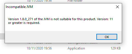

OK, so I did that, and I got an error (see attached) when launching eclipse.
If I open the version of eclipse installed by the college, it opens normally but seems to still be using the installed version of the JVM. If I try to add the version I installed in settings it doesn't work (it says it's missing).
Back to the drawing board I think!

That's because, as I said, your JAVA_HOME and PATH (more important than JAVA_HOME) are not set correctly. It's not finding your Java 15 distribution because it's not in the PATH. It has to point to the bin directory in your Java 15 distribution.

So do you have two JDK installations in your PATH at the same time? Is the Java 8 one earlier in the PATH than the other one? That would produce these results.
