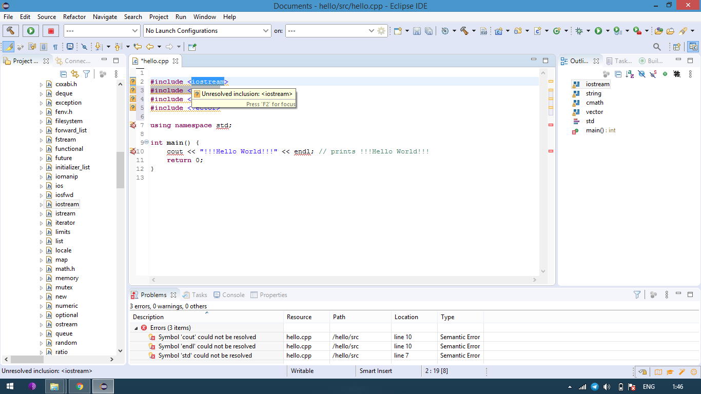

My eclipse+mingw are refusing to compile my code, stating that every library is missing and syntax is wrong because of it. However the truth is that I think I linked everything right (left to the code we can see iostream- this is the included tab in project manager), but it isn't working. What's wrong? Codeblocks 17.12 i had earlier is running just fine, compiling everything like it used to.
Please help, I think I have tried everything imaginable at this point to make it work.

Eclipse/CDT and the compiler are separate entities.
Eclipse/CDT does have a parser to aid indexing.
The errors you are getting are from the parser in CDT.
They are caused by it not knowing where the header files are.
Telling it where they are can be complicated to briefly explain.
This article might help:
https://www.eclipse.org/community/eclipse_newsletter/2013/october/article4.php

so i forgot to comment but to get my eclipse working with mingw i needed to download mingw-get from their site an explicitly check to install msys and put msys in path an that got everything working. thanks for the help, i manage to figure it out eventually.
