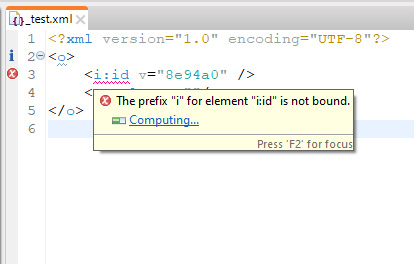

I installed new version Eclipse 2020-09 for Java and now the Xml Editor, when opening my old xml files, gives errors in the <name: subname> constructions, indicating that there is no schema for 'subname' (see attached picture). But I don't need such circuits. these files are generated by someone else's program and it is impossible to describe all variants of 'name: subname' and their possible parameters. This error makes it very difficult to view such files and find other real errors in them.
Previous versions of Eclipse 2020-03 and earlier did not have this bug, it only appeared in the latest version.
Moreover, this error is not detected during 'Validate', it is shown only if you open this file in an XML editor.
Can you please tell me how to remove this error in the Eclipse XML editor? I have looked through every possible XML setting but nothing seems to help!

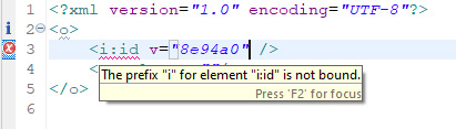

Does the message both 1) not appear in the Markers/Errors views and 2) appear when you open the file in the Generic Editor?
Re: Eclipse 2020-09 (for Java) XML Editor shows new errors which were not there before. What to do? [message #1834498 is a reply to message #1834496] Wed, 11 November 2020 08:41 Go to previous messageGo to next message
Nitin Dahyabhai wrote on Wed, 11 November 2020 13:15
1) If file not opened "view Problems" does not show this error, but where file open - this error show from "view Problems"
2) "Generic text Editor" show this error also as "XML Editor"
image from Generic Editor:
index.php/fa/39255/0/
[Updated on: Wed, 11 November 2020 08:46] by Moderator
Re: Eclipse 2020-09 (for Java) XML Editor shows new errors which were not there before. What to do? [message #1834499 is a reply to message #1834498] Wed, 11 November 2020 08:46 Go to previous messageGo to next message
You'll want to report this to https://github.com/eclipse/wildwebdeveloper/issues so they can untangle how to either turn it off or fix this bug (as in, you should only see well-formedness-related messages when your document lacks XML Schema and DTD references).

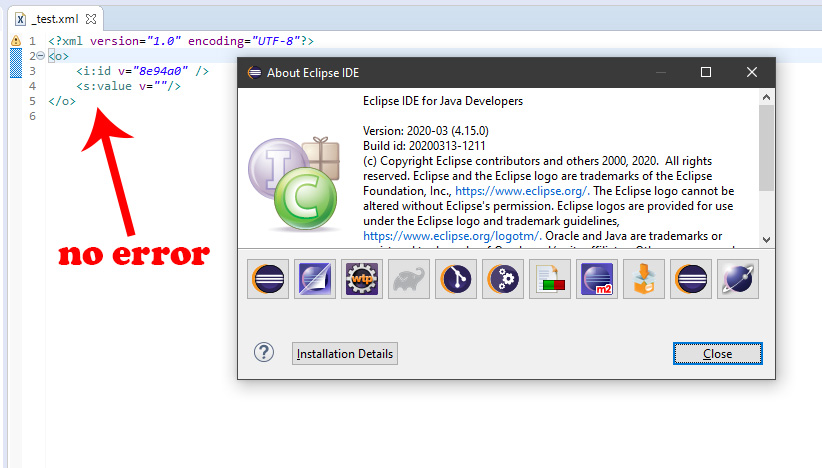

Ed Willink wrote on Wed, 11 November 2020 14:26
IMHO The images look like bad XML that should be reported by any version of the tool in the last ten years. You must specify your xmlns. If you can confirm a lack of error on some recent tool, please raise a bug.
see screen shot previous version eclipse 2020-03
index.php/fa/39259/0/
(you should only see well-formedness-related messages when your document lacks XML Schema and DTD references)

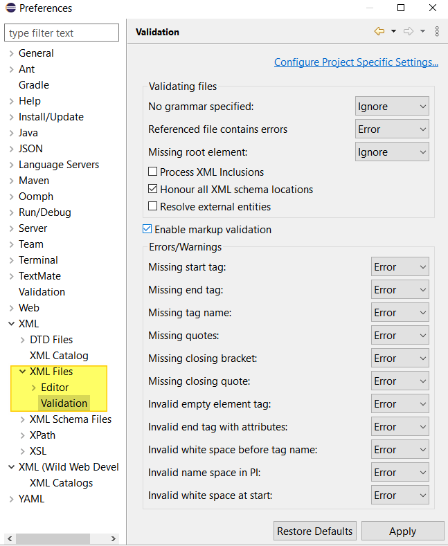

Hi there,
I have Version: 2020-09 (4.17.0).
There are some settings that might do the job (I did not test it.)
index.php/fa/39264/0/
Regards.
Re: Eclipse 2020-09 (for Java) XML Editor shows new errors which were not there before. What to do? [message #1834545 is a reply to message #1834542] Thu, 12 November 2020 03:42 Go to previous message

I turned off all these errors altogether - and none of them worked. As I said above, these are settings for "Validate" and it worked without error before. I even turned off "Validate" for verification, but in the XML Editor the error is still shown!
The error is only in XML Editor and these settings do not affect it!
