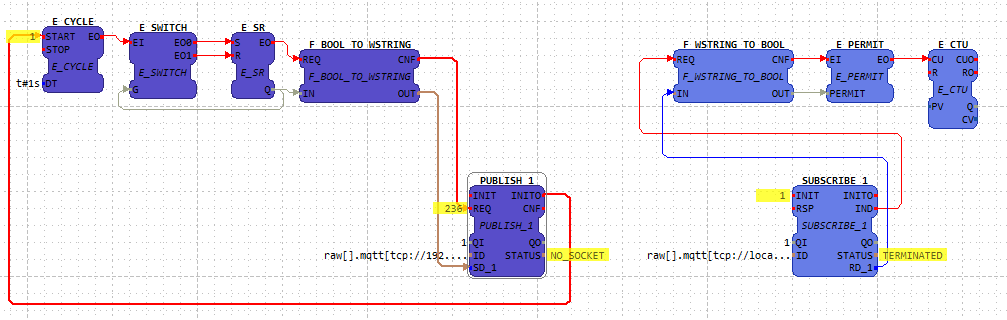

Now I am using blink program as attached to test. Execution of blinking and counting part are both on localhost connected to each other using Publish and Subscribe FBs as shown in the attachment. But when i put ID of Publish as "raw[].mqtt[tcp://192.168.225.180:1883, forte, output]" and ID of Subscribe as "raw[].mqtt[tcp://192.168.225.180:1883, forte, input]", the STATUS output of Publish FB shows "NO SOCKET" and STATUS output of Subscribe FB shows "TERMINATED".

I'm not as fit in MQTT as I would like to be. But one thing that I noticed is that you connected your SD_1 and RD_1 to WSTRING pins. However the raw layer expects pins of type STRING.
NO_SOCKET means that you tried to send something but the FB could not be initialized. So most probably the init failed. For such test I typically do not connect INITO so that I can manually trigger the different events and see the results.

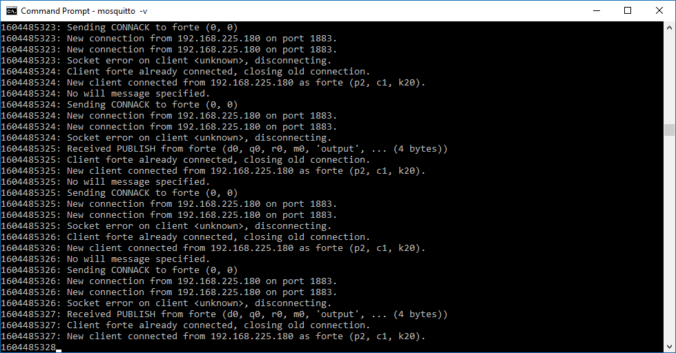

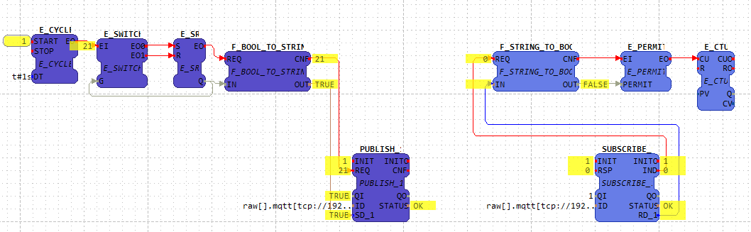

Thankyou very much Alois. I did the changes suggested by you and now i can see some activities on my broker screen. However, i am still unable see data transferring from Publish to Subscribe. I can see 'OK' on STATUS' output of both Publish and Subscribe FBs. I can see SD_1 input of Publish continuously toggling (true-false) as per blink program logic but i do not see same toggling data on RD_1 output of Subscribe. Also RSP input of Subscribe is 0. Even if i manually trigger this event to 1 there is no effect. Attached is changed 4Diac program and activity messages on Broker screen. Please guide further.

I think it would definitely good if you familiarize yourself with MQTT. MQTT is a broker based system where your publish and subdscribes go to a dedicated broker. 4diac FORTE has currently the limitation that within one 4diac FORTE instance you can connect only to one broker. So in your use case you would have somewhere a broker and you specify the broker's address in all of your publish and subscribes.
Regarding your problem: I don't see your full subscribe and publish ID values, but from the description you gave in your first post I think you have to learn about the concept of MQTT topics. An MQTT topic is an identifer you can publish or subscribe to. If you have a publisher and a subscriber which you would like that they are communicating with each other about the same topic you have to specifiy the same topic in both. If I see your code above correctly you have a differetn topic for your subscribe. As noboday is publishing to this topic you are also not receiving anything.

Thank you Alois. After digging out lot on MQTT concept i realized that name of clients have to be different and topics should be same. So i made corrections to name of clients and topics and now it works fine for me. Thanks again.
