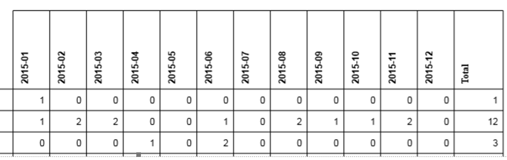

Hello!
I'm trying to find out how I can rotate the text in BIRT to be vertically (like the date is shown in the attachment).
From earlier discussions, it seems like I have to download an extension pack, but the discussion is quite a while ago.
Could someone help me with this?
I want the date to be displayed like in the attachment.
Thank you!
  • Attachment: eeeee.PNG
    (Size: 48.85KB, Downloaded 328 times)
Re: Text rotation in Birt Designer [message #1834133 is a reply to message #1834131] Tue, 03 November 2020 09:52 Go to previous messageGo to next message
Try Der Spunk's solution from this post
https://www.eclipse.org/forums/index.php/t/51348/
If you are using a crosstab like in your picture, you just want to use the "value-of" your dimension.
Re: Text rotation in Birt Designer [message #1834135 is a reply to message #1834133] Tue, 03 November 2020 10:24 Go to previous messageGo to next message
If you want to write it bottom up use the code below.
<span style="writing-mode: vertical-rl; transform: rotate(-180deg);"><VALUE-OF>yourcolumn</VALUE-OF></span>
Re: Text rotation in Birt Designer [message #1834167 is a reply to message #1834135] Wed, 04 November 2020 04:18 Go to previous message
Thank you, I'll try. I want it to be vertically, not upside down, but I guess I replace the -180 with -90.
