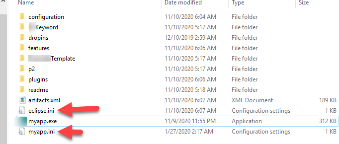

1. Using eclipse-platform-4.17-win32-x86_64, replace "eclipse.exe" with our pre-built "myapp.exe"
2. Replace "eclipse.ini" with "myapp.ini"
4. Launch "myapp.exe"
5. install plugins to create our product and restart
6. Install JustJJre, using it's update site https://download.eclipse.org/justj/jres/11/updates/release
Result:
1. JustJ created new "eclipse.ini" which contains "-vm" arg and "myapp.ini" wasn't updated. Please see below screenshot.
index.php/fa/39246/0/

Re: [Inquiry] JustJ installation creates new eclipse.ini instead of updating <app>.ini [message #1834449 is a reply to message #1834438] Tue, 10 November 2020 09:30 Go to previous messageGo to next message
No doubt somewhere in the metadata of the installation it still knows that the files should be called eclipse.exe, eclipsec.exe and eclipse.ini, so any update to those, or touch points to change those, will use the old/expected names.
This is not how you should create a branded product. You should build one using Tycho with your own *.product file with the proper branded name so that the metadata is consistent with the artifact names.
