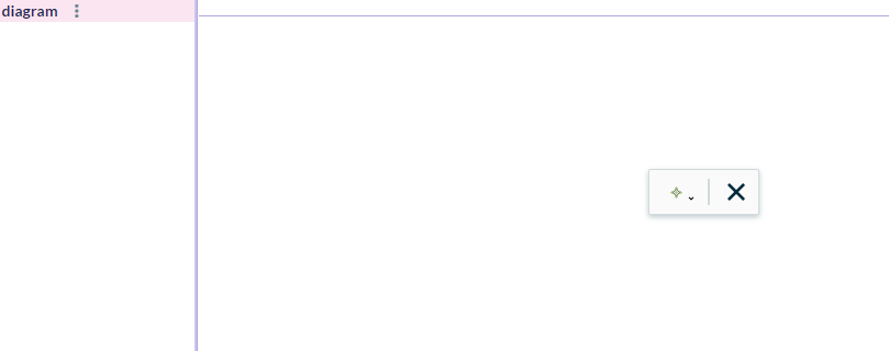

Thank you very much for the documentation. It has worked well for me to adapt our modeling.
The only error I have had has been when adding elements to the diagram, which has not allowed us to show/add elements from a diagram. The error has been the following:
2020-10-26 21:20:26.888 DEBUG 10832 --- [d5-a20d676f4c7a] o.e.s.w.s.c.forms.FormEventProcessor : Form refreshed: Form {id: 62e93f82-e272-3ce9-b6c7-f58a4d734ae6, label: Form, targetObjectId: b8bbfd74-3b22-4d9b-b7d8-154c1285c90d, pageCount: 1})
2020-10-26 21:20:26.892 DEBUG 10832 --- [d5-a20d676f4c7a] o.e.s.w.s.g.w.h.StartMessageHandler : Message sent: DataMessage {id: 9, type: data, payload: formEvent}
2020-10-26 21:20:26.897 ERROR 10832 --- [nio-8080-exec-4] o.e.s.w.s.c.p.ProjectEventProcessor : java.lang.NullPointerException
java.util.concurrent.ExecutionException: java.lang.NullPointerException

Caused by: java.lang.NullPointerException: null
at org.eclipse.sirius.web.interpreter.ExpressionConverter.convertExpression(ExpressionConverter.java:57) ~[sirius-web-interpreter-0.1.0-SNAPSHOT.jar!/:0.1.0-SNAPSHOT]
at org.eclipse.sirius.web.interpreter.AQLInterpreter.evaluateExpression(AQLInterpreter.java:108) ~[sirius-web-interpreter-0.1.0-SNAPSHOT.jar!/:0.1.0-SNAPSHOT]

Thanks!
  • Attachment: diagram.PNG
    (Size: 5.03KB, Downloaded 76 times)

Re: Upload my own odesign file to Sirius Web [message #1833946 is a reply to message #1833945] Wed, 28 October 2020 11:45 Go to previous messageGo to next message
From the look of the stack posted by Alejandro, it seems the the odesign file defines a conditional style which does not specify a predicate expression.
The code should be more robust to this, I'll open a ticket.
In the meantime, you should be able to workaround it by making sure all conditional styles have a predicate, even if it is just "aql:true"
Pierre-Charles
