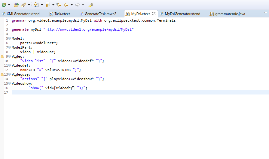

Hey, I have written the Java code and the grammar also. Now, I am facing difficulty in writing the xtend code. I am attaching everything please have a look and help. Thanks in advance.
Grammar
Model:
parts+=ModelPart*;
ModelPart:
Video | Videouse;
Video:
"video_list" "{" videos+=Videodef* "}";
Videodef:
name=ID "=" value=STRING ";";
Videouse:
"actions" "{" playvideo+=Videoshow* "}";
Videoshow:
"show(" vid=[Videodef] ");";

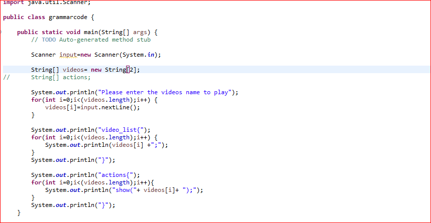

Java Code
import java.util.Scanner;
public class grammarcode {
// TODO Auto-generated method stub
Scanner input=new Scanner(System.in);
String[] videos= new String[2];
// String[] actions;
System.out.println("Please enter the videos name to play");
for(int i=0;i<(videos.length);i++) {
videos[i]=input.nextLine();
System.out.println("video_list{");
System.out.println(videos[i] +";");
System.out.println("}");
System.out.println("actions{");
for(int i=0;i<(videos.length);i++){
System.out.println("show("+ videos[i]+ ");");

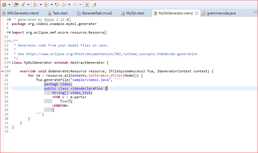

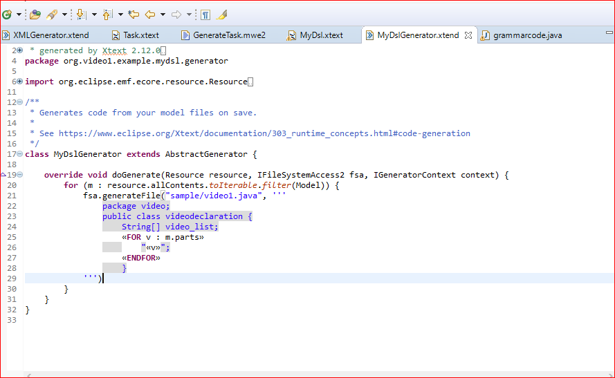

Re: xtend code [message #1833778 is a reply to message #1833776] Fri, 23 October 2020 13:11 Go to previous messageGo to next message

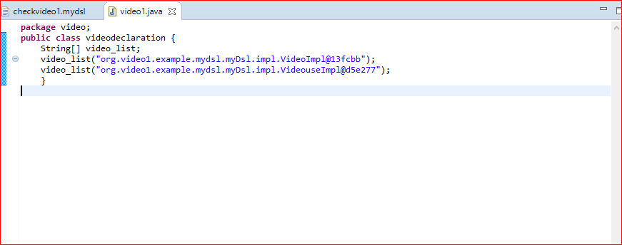

Can you convert my Java code into the xtend code which I can write in the mydslGenerator.xtend file. So that after running the mydslGenerator.xtend file java code will be generated?
Please see the attachment.
  • Attachment: xtend.PNG
    (Size: 34.50KB, Downloaded 100 times)

Re: xtend code [message #1833781 is a reply to message #1833779] Fri, 23 October 2020 13:29 Go to previous messageGo to next message
This is my Grammar:
grammar org.video1.example.mydsl.MyDsl with org.eclipse.xtext.common.Terminals
generate myDsl "http://www.video1.org/example/mydsl/MyDsl"
Model:
parts+=ModelPart*;
ModelPart:
Video | Videouse;
Video:
Videodef:
Videouse:
Videoshow:

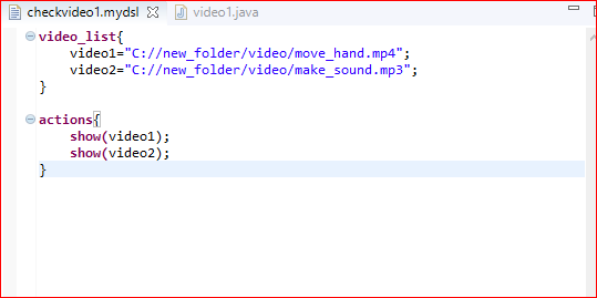

That how my grammar will look when it is tested
video_list{
video1="C://new_folder/video/move_hand.mp4";
video2="C://new_folder/video/make_sound.mp3";
actions{
show(video1);
show(video2);
Now from the grammar I want to generate the java code
I am also attaching the screenshots of my grammar file, tested grammar file, and both the other screenshot where I tried to write the code( named logic file) so that java code will be generated and its output what I get.

Below java code I want to generate

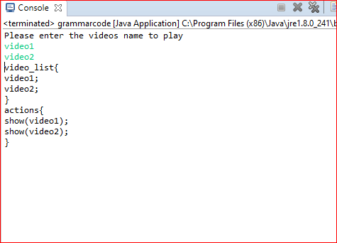

Re: xtend code [message #1833788 is a reply to message #1833787] Fri, 23 October 2020 14:27 Go to previous messageGo to next message
Now, If you understand the scenario please update my code and you can clearly see in my code, first I am taking input from the user and I am also attaching a screenshot of my code output.
I write the code in a simple java environment and not in the xtend environment.Through xtend I want to generate java code.
I am newbie that's why I don't know how to write the logic in .xtend file.
  • Attachment: output.PNG
    (Size: 9.80KB, Downloaded 78 times)
[Updated on: Fri, 23 October 2020 14:27] by Moderator

Re: xtend code [message #1833790 is a reply to message #1833789] Fri, 23 October 2020 14:46 Go to previous messageGo to next message
I just show you the java app for understanding and also write java code for my own understanding. This code has nothing to do with the generator.
I think you still not understand my point.
Can you please write a code in the mydslgenerator.xtend file according to my grammar and the tested grammar? So that I can understand.
Right now, I am facing difficulty in the syntax of the xtend.

Re: xtend code [message #1833795 is a reply to message #1833794] Fri, 23 October 2020 16:10 Go to previous message
that is easy
override void doGenerate(Resource resource, IFileSystemAccess2 fsa, IGeneratorContext context) {
		for (m : resource.allContents.toIterable.filter(Model)) {
			fsa.generateFile("video/videodecl.txt", '''
			video_list{
			«FOR v : m.parts.filter(Video)»
				«FOR vd : v.videos»
					name="«Strings.convertToJavaString(vd.value)»";
				«ENDFOR»
			«ENDFOR»
			action{
			«FOR u : m.parts.filter(Videouse)»
				«FOR play : u.playvideo»
					show(«play.vid.name»);
				«ENDFOR»
			«ENDFOR»
but this aint java code that is generated
[Updated on: Fri, 23 October 2020 16:11] by Moderator
