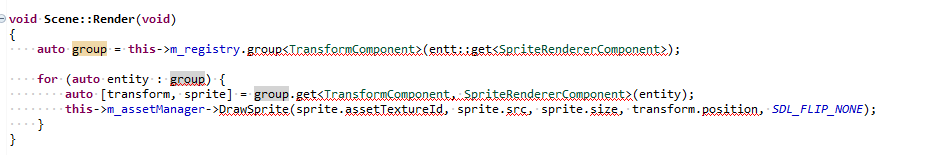

I'm using a third party template library called "entt".
For certain methods of that library, Eclipse shows errors for perfectly fine code, see attachment.
The code compiles without errors and warnings perfectly well. I'm using MinGw as toolchain, am I missing a certain setting?

Thank you for your response.
Include paths are correctly set up. I can even use the structures and methods defined int the .hpp.
It seems for complex operations where methods are nested in combination with the "auto" keywoard, Eclipse just can't resolve that and tells me that are unknown symbols.

Could be.
All of the flagged errors after auto group appear secondary.
So you only need to find out why it's flagged.
I don't have any way to reproduce this.
Suggest filing a bug report.
