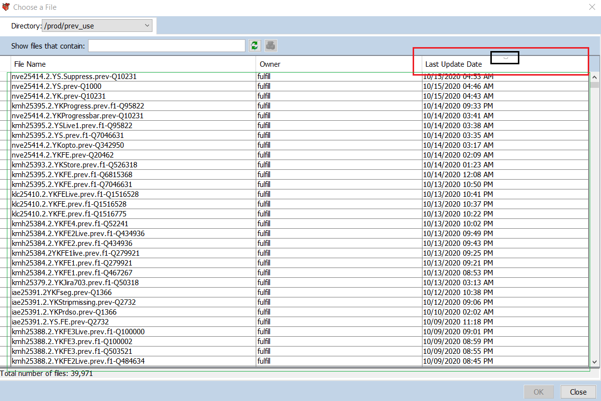

I am trying to identify the object mapping of table column , but I cannot see the green box surrounding the column.
I need to click on the table column name to perform certain functionality.
Complete table is getting identified( ie green box is coming surrounding the complete table rows below the column headers.)
Please help , any leads is really apreciated

Hi Every one ,
Please refer screenshot attached for the issue I am facing.

You can not directly access such special column headers. Object Mapping works only for the complete Component.
Maybe you can indireclty click them by clicking the first row in the column, or use the Header actions which are existing in some toolkits.
Or are there some Keyboard shortcuts, which can help?
Also there is the possibility to write an extension, so that you can support such kind of tables, but this is a complex task.
