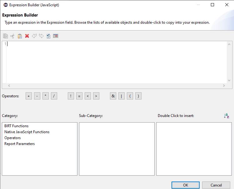

Yes, I am using open source Birt and I am able to define parameters, but I am not able to send value of x label as parameter.
I tried with row["productType"], but it always takes last label value on x axis (in my example product 4). In expression builder 'Available Column Bindings' option is not available, same option is available in Value (Y) Series Interactivity, screenshot is attached.

You should use the Y series interactivity option as the drill through option if you are trying to pass the X axis value. It will filter that particular column when you match it to the drill through report's parameter.
I think they just built it this way so they don't have conflicting actions.
