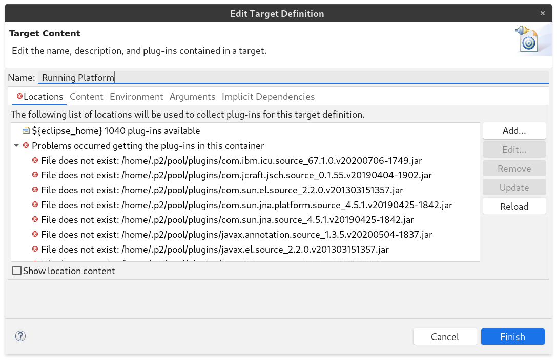

Please consider the first part of my previous post obsolete. I think I figured out what you mean and it pointed me to the cause of the issue. Taking a look at the Running Platform target, I can see that Eclipse fails to locate the source plug-ins because it expects to find them at the wrong location (see attachment).
When I create a filesystem link from /home/.p2 to ~/.p2, everything works as expected. Is it maybe possible to configure the location that Eclipse expects to find the .p2 directory directly?
