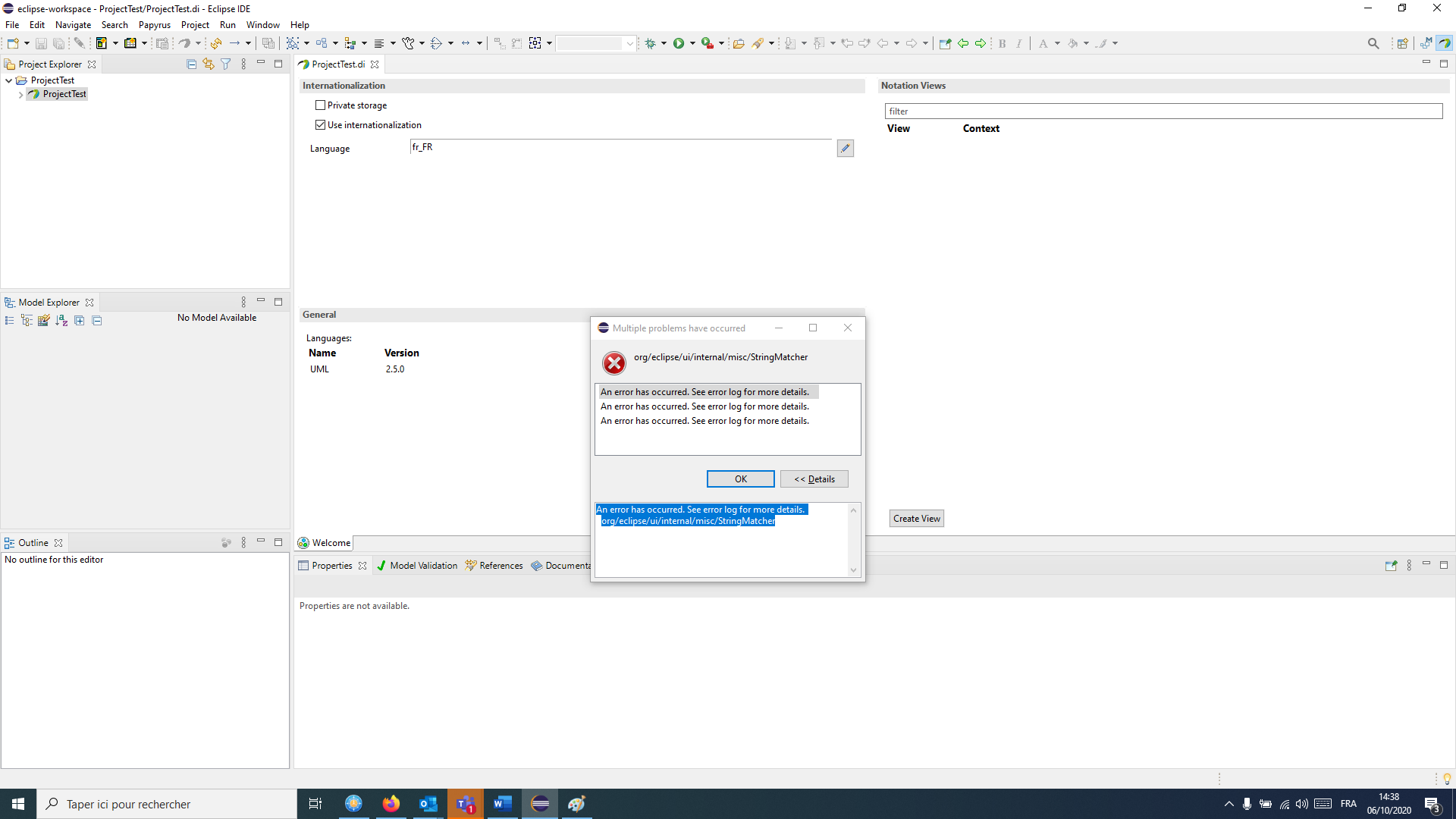

Hello everybody,
I would like to use Papyrus to describe several systems.
I've installed Eclipse modeling tools 2020 09 and then Papyrus from help/install new software menu.
When I use the papyrus perspective, i've got this error :
An error has occurred. See error log for more details.
org/eclipse/ui/internal/misc/StringMatcher
Is there somebody that can help me about this error ?
Thanks a lot :)

It looks like there is an incompatibility between the Papyrus Model Explorer and Eclipse 2020 09.
The Model Explorer seem to crash on startup :-( So, you can't see it.
The only turn around that I have found is to use Eclipse 2020 06 with Papyrus.
Cedric

Probably caused by:
[cross-project-issues-dev] Wildcard string matching: removal of org.eclipse.ui.internal.misc.StringMatcher
posted on 14/07/2020
Ed Willink
I plan to remove class org.eclipse.ui.internal.misc.StringMatcher in 4.17 M2.
This is an *internal* non-API class in bundle org.eclipse.ui.workbench.
As far as I see there are three direct uses of this class outside of Eclipse platform:
* Mylyn Context: https://bugs.eclipse.org/bugs/show_bug.cgi?id=564946
* Babel Plugins: https://bugs.eclipse.org/bugs/show_bug.cgi?id=564952
* Viatra: https://bugs.eclipse.org/bugs/show_bug.cgi?id=564950
(I found those via a Google search; there might be more.)
These projects should migrate away from importing org.eclipse.ui.internal.misc.StringMatcher.
There is an official API class org.eclipse.ui.dialogs.SearchPattern that can be used
to get the functionality of org.eclipse.ui.internal.misc.StringMatcher.
Since org.eclipse.core.runtime 3.18.0 there is also an API class
org.eclipse.core.text.StringMatcher that implements basic wildcard matching.
The current org.eclipse.ui.internal.misc.StringMatcher does more; it splits the pattern
on whitespace and tries to match sub-patterns against words in the text. There is a
new replacement for this called org.eclipse.ui.internal.misc.TextMatcher since
org.eclipse.ui.workbench 3.120.0, but that is also an internal non-API class.
If your code needs this word-splitting behavior, use org.eclipse.ui.dialogs.SearchPattern,
which has existed for a long time already. Otherwise use org.eclipse.core.text.StringMatcher.
Cheers,
Thomas
Re: StringMatcher error [message #1833268 is a reply to message #1833214] Thu, 08 October 2020 03:59 Go to previous messageGo to next message
As far as I know, the StringMatcher problems have been fixed in the nightly build. I.e. use the update site http://download.eclipse.org/modeling/mdt/papyrus/updates/nightly/master
See also https://bugs.eclipse.org/bugs/show_bug.cgi?id=567323
Ansgar

No, as Patrick has said in https://www.eclipse.org/forums/index.php/t/1104191/ we focus our work on version 2020-12., and we do not deliver a version for 2020-09.
However, as said before, you can install Papyrus in Eclipse 2020-09 by adding the nightly update site mentioned in my post above.

I have installes 2020 12 and I still experience the same issue. I tried to add the nightly link you have posted for 2020 09 but it did not have any effect (also a little bit expected)
Re: StringMatcher error [message #1838749 is a reply to message #1838560] Thu, 04 March 2021 08:01 Go to previous messageGo to next message
Did you do a fresh installation of Eclipse 2020-12? You do not need a specific update site, as Papyrus is part of the release train.
Re: StringMatcher error [message #1838769 is a reply to message #1838749] Thu, 04 March 2021 14:03 Go to previous messageGo to next message
I also tried everything with the fresh releases but once I upload SysML1.6 or 1.4, it gives me the same error.
Re: StringMatcher error [message #1838932 is a reply to message #1838769] Tue, 09 March 2021 13:33 Go to previous message
SysML 1.4 and SysML 1.6 have not been released recently. Thus, they depend on an older version of Papyrus which is not compatible with 2020-12. Install SysML via an update-site containing a nightly build of SysML, e.g. https://ci.eclipse.org/papyrus/view/Sysml/job/papyrus-sysml16-master/
