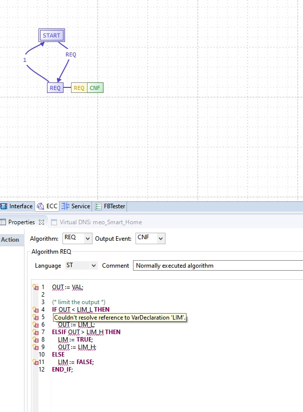

Hi all,
I have upgrade from 1.9.0 to 1.12.2 and when I check my function blocks I can see this error at any variable - see image.
All FBs are working fine by the way in 1.12.2!
Wolfgang
  • Attachment: screen.jpg
    (Size: 130.35KB, Downloaded 111 times)
[Updated on: Thu, 08 October 2020 10:22] by Moderator
Re: Couldn't resolve reference to VarDeclaration [message #1833297 is a reply to message #1833012] Thu, 08 October 2020 10:22 Go to previous messageGo to next message
To explain it a bit better:
The FB in the screenshot works perfect.
I think its only a visual problem.
[Updated on: Thu, 08 October 2020 10:23] by Moderator
Re: Couldn't resolve reference to VarDeclaration [message #1833309 is a reply to message #1833297] Thu, 08 October 2020 14:48 Go to previous messageGo to next message
sorry for the late reply. I had to look into the problem a bit and i think we have an editor refresh problem. If click on the background and then select the algorithm tab from the property sheets and use there the algorithm editor you shouldn't see these problems. Unfortunately I currently don't know how to fix your issue. But I hope the workarround helps you for now a bit.
Re: Couldn't resolve reference to VarDeclaration [message #1833323 is a reply to message #1833309] Fri, 09 October 2020 03:45 Go to previous message
Thank you for your help! I only want to get sure that my upgrade has succeeded.
Maybe you will report that issue and it will be fixed at one of your next releases.
Wolfgang
