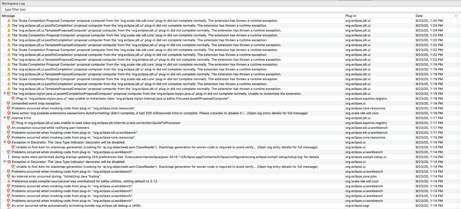

My eclipse upgraded itself to 2020-09 yesterday. I'm really shocked it was released with this much instability in it. If there is so many problems (unexpected crashes, plugin errors, etc), why did it get forced to be released today!
Re: Eclipse 2020-09 crashes repeatedly, errors with multiple plugins [message #1832719 is a reply to message #1832718] Wed, 23 September 2020 16:21 Go to previous messageGo to next message
Is there any easy way to rollback a 2020-09 continuous build upgrade to revert back to 2020-06?
Re: Eclipse 2020-09 crashes repeatedly, errors with multiple plugins [message #1832720 is a reply to message #1832719] Wed, 23 September 2020 16:22 Go to previous messageGo to next message

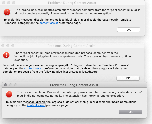

I can see all the Scala-IDE content assists are failing in the auto-complete logic again :(
Re: Eclipse 2020-09 crashes repeatedly, errors with multiple plugins [message #1832722 is a reply to message #1832720] Wed, 23 September 2020 16:29 Go to previous messageGo to next message
index.php/fa/38972/0/The Java postfix Template is also failing in the content assist as well as is the TemplateProposalComputer! index.php/fa/38973/0/
[Updated on: Wed, 23 September 2020 16:31] by Moderator

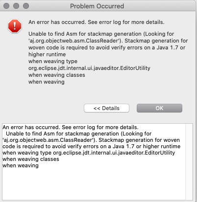

Errors occurred during the build.
Errors running builder 'Scala Builder' on project 'resolverservice'.
Unable to find Asm for stackmap generation (Looking for 'aj.org.objectweb.asm.ClassReader'). Stackmap generation for woven code is required to avoid verify errors on a Java 1.7 or higher runtime
when weaving type org.eclipse.jdt.internal.compiler.lookup.MethodVerifier
when weaving classes
when weaving
when weaving

Re: Eclipse 2020-09 crashes repeatedly, errors with multiple plugins [message #1832728 is a reply to message #1832724] Wed, 23 September 2020 18:04 Go to previous messageGo to next message
index.php/fa/38974/0/I've tried creating a new workspace -> doesn't work
I've tried downloading / installing a new Eclipse 2020-09 from scratch -> fewer errors but nothing compiles. Also I can only open scala classes using a text editor. (Both compiling and file opening) fail on the "required to avoid verify errors on a Java 1.7 or higher runtime when weaving type org.eclipse.jdt.core.search.SearchDocument when weaving classes when weaving" error :(

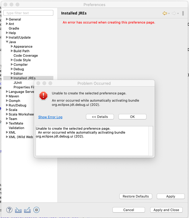

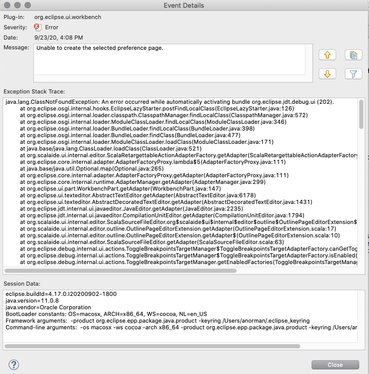

Re: Eclipse 2020-09 crashes repeatedly, errors with multiple plugins [message #1832729 is a reply to message #1832728] Wed, 23 September 2020 18:09 Go to previous messageGo to next message
index.php/fa/38976/0/index.php/fa/38975/0/when I try to navigate to the eclipse/preferences/installed JREs settings I get another failure and the screen doesn't render
Errors running builder 'Scala Builder' on project 'sfsync-resolve'.

Re: Eclipse 2020-09 crashes repeatedly, errors with multiple plugins [message #1832772 is a reply to message #1832736] Thu, 24 September 2020 12:38 Go to previous messageGo to next message
I seems like the scala systems have issues. Java seems broken too (see my above screenshot of the "installed JREs preferences panel not loading").

Re: Eclipse 2020-09 crashes repeatedly, errors with multiple plugins [message #1832779 is a reply to message #1832773] Thu, 24 September 2020 17:11 Go to previous messageGo to next message
You can develop your projects against Java 1.8 just fine in 2020-09. Eclipse itself needs Java 11.
Re: Eclipse 2020-09 crashes repeatedly, errors with multiple plugins [message #1833693 is a reply to message #1832718] Wed, 21 October 2020 12:33 Go to previous message
I updated my JDK from OpenJDK 11.0.4.11 to 11.0.8.10 seems to have resolved the problems for me. I use the eclipse zip install method.
