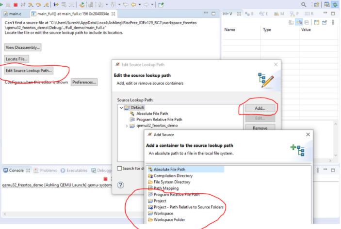

i have tried to Edit the source lookup path but none of the container options are not working , did eclipse CDT deprecate+ any of these options ?

They work for me.
Perhaps a little more context is needed.
Why do you think they aren't working?

when i tried to run it from the product when I map the source file using any of these container its not detecting the source code.
Re: Edit source lookup path options are not working [message #1832858 is a reply to message #1832853] Sun, 27 September 2020 22:06 Go to previous message
Without more specific information it isn't possible to help you.
Understand that although the dialog says "container" it isn't referring to something like a Docker container.
It should have said "path type" or similar.
Perhaps reading what gdb does to find the source may help.
The following may be for an earlier version of gdb but it hasn't changed:
https://sourceware.org/gdb/onlinedocs/gdb/Source-Path.html
https://ftp.gnu.org/old-gnu/Manuals/gdb/html_node/gdb_48.html
