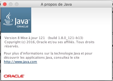

I've downloaded JRE 1.8 0.121 64bits (I hope so as I found only file "jre-8u121-macosx-x64.dmg") and I've installed it.
Looking at my system preferences, I see JAVA version 8 build 1.8.0_121-b13.
