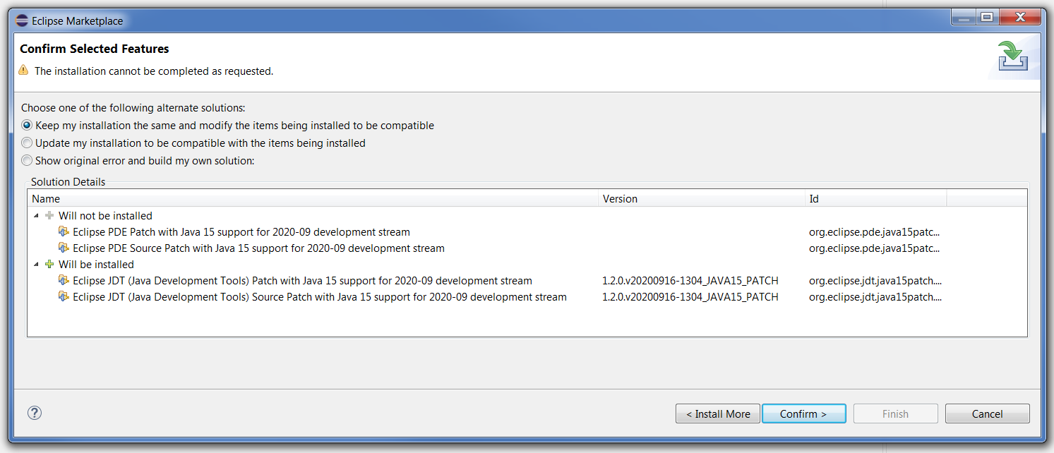

My guess is that he is referring to this marketplace entry where there seem to be quite a few errors from users trying it:
https://marketplace.eclipse.org/content/java-15-support-eclipse-2020-09-417#bootstrap-panel--2
When I try it in my fresh new Java IDE 2020-09 it results in this:
index.php/fa/38938/0/
I doesn't think I'm able to install the PDE patch. Likely that's because the Java IDE doesn't have the full PDE feature installed, and this listing says the PDE patch is required, though I think it's not required if the PDE feature isn't installed...

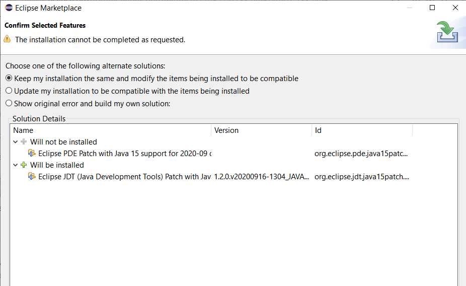

May I add my two cents....
I have:
- Windows 10
- eclipse-java-2020-09-R-win32-x86_64.zip
- openjdk-15_windows-x64_bin.zip
I got a similar screen like Ed Merks:
index.php/fa/38942/0/
index.php/fa/38943/0/

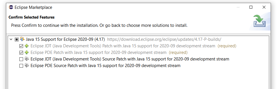

When you hit confirm eclipse will install the patch:
index.php/fa/38944/0/
