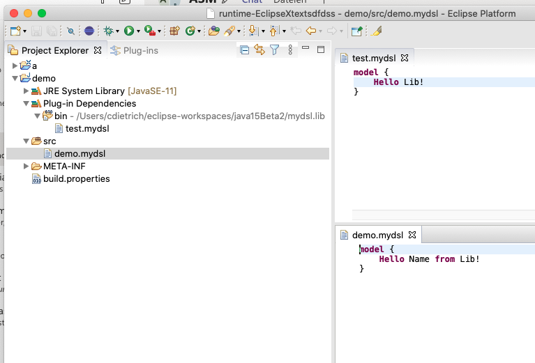

Re: Unresolved reference with dsl in jar library [message #1832416 is a reply to message #1832413] Thu, 17 September 2020 10:18 Go to previous messageGo to next message
does it look the same for you?
index.php/fa/38924/0/

Re: Unresolved reference with dsl in jar library [message #1832419 is a reply to message #1832417] Thu, 17 September 2020 10:26 Go to previous messageGo to next message
Yes it looks the same.
