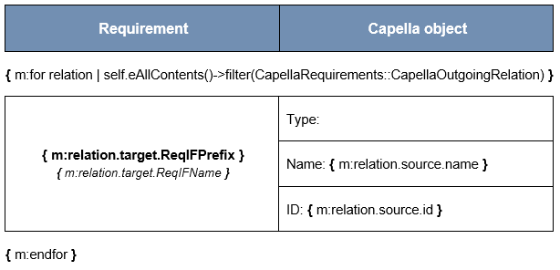

At a certain point in the document, I would like to have a requirement traceability table that links the requirements with the Capella elements that are allocated to them. Here is what I tried to do to achieve this:
index.php/fa/38916/0/

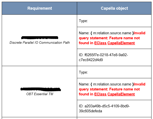

But then something weird happens. Everything works great except for the "Name" section where I got an error in the generated file, which says : "Feature name not found in EClass CapellaElement":
index.php/fa/38918/0/

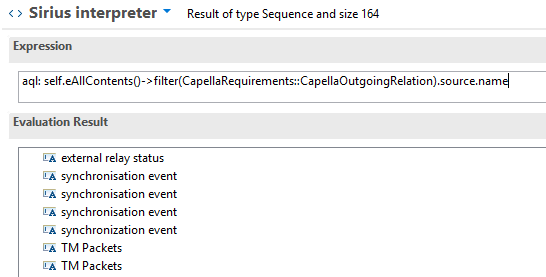

However, when I use the Sirius interpreter in Capella, it seems that it should normally work:
index.php/fa/38917/0/

The EClass CapellaElementdoesn't has a feature name. You will need to cast the source element to capellacore::NamedElement:
relation.source.oclAsType(capellacore::NamedElement).name
Of course this will only works if the source is a NamedElement.
To retrieve the type of an element you can use element.eClass().
