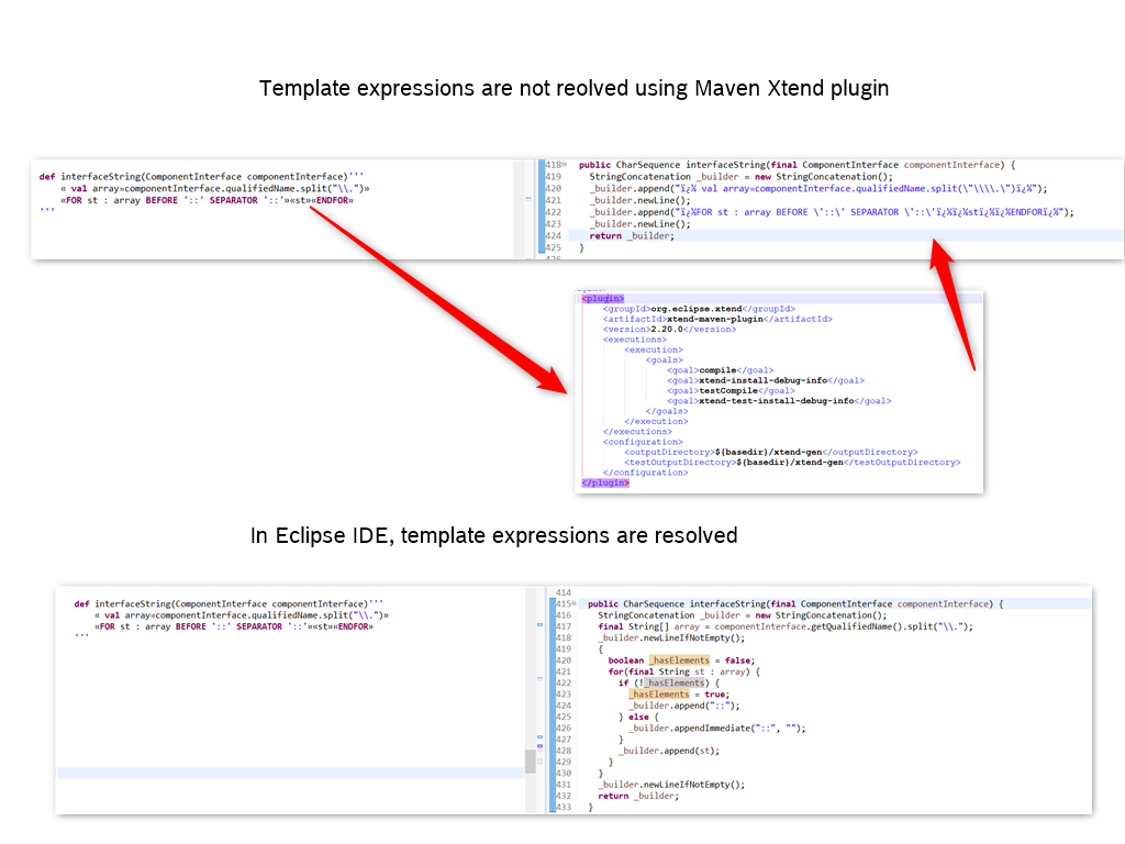

I am using Xtend for model to text use-case. I am creating a RCP product and have used maven to build the product from the eclipse plugins.
I realized that the generated code from Xtend file, is different in both development envrionment (inside Eclipse IDE) and build envrionment (generated using Xtend maven plugin).
I realized that in the build environment, Xtend expressions are not resolved and the entire content is dumped as a text. Please find the below screenshot for reference
index.php/fa/38862/0/
It will be helpful if you can let me know if I need to do some change in the build configuration to get the same output.

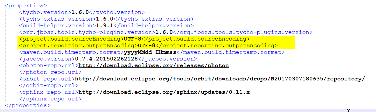

This property (project.build.sourceEncoding) is already set in the parent pom.xml of my project, but still there is no influence of it (guillemot's are not recognized and are dumped as text with special charaters)

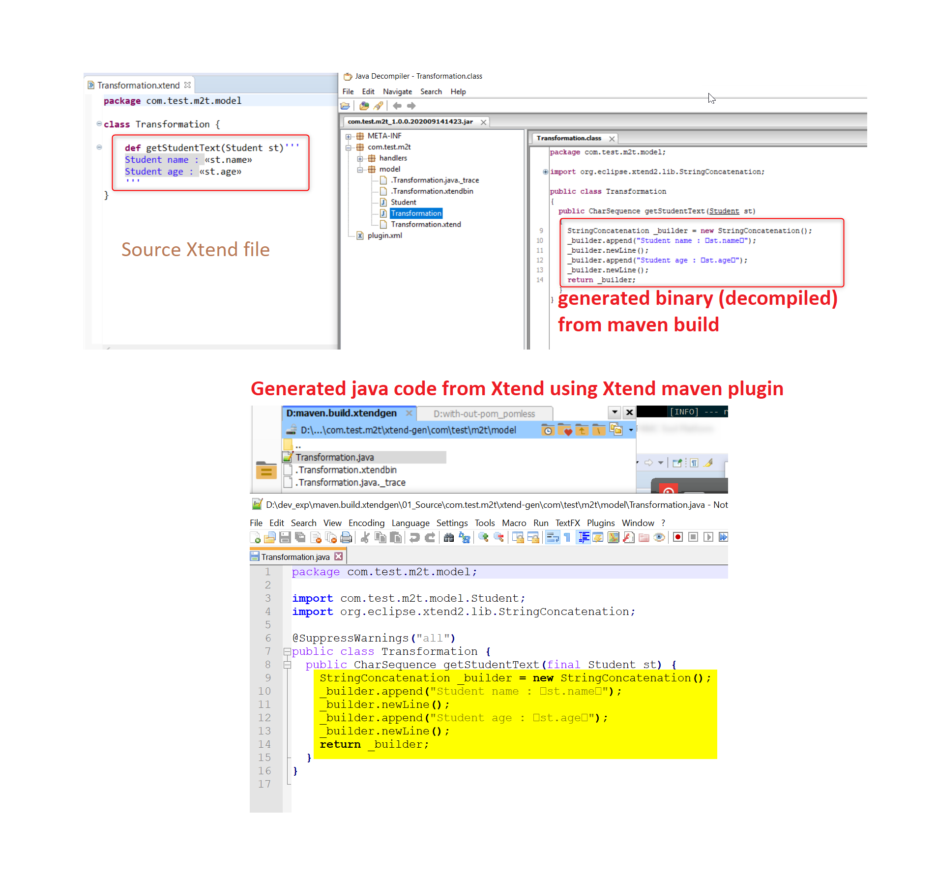

I have create a example application containing xtend files (using template expressions) : https://www.eclipse.org/forums/index.php?t=getfile&id=38896&
- you can build this example using mvn clean verify command and verify the generated java file . \maven.build.xtendgen\01_Source\com.test.m2t\xtend-gen\com\test\m2t\model\Transformation.java
I have created a screenshot of input xtend, generated java file and decompiled class file after the build in my local PC : https://www.eclipse.org/forums/index.php?t=getfile&id=38897&
index.php/fa/38897/0/
