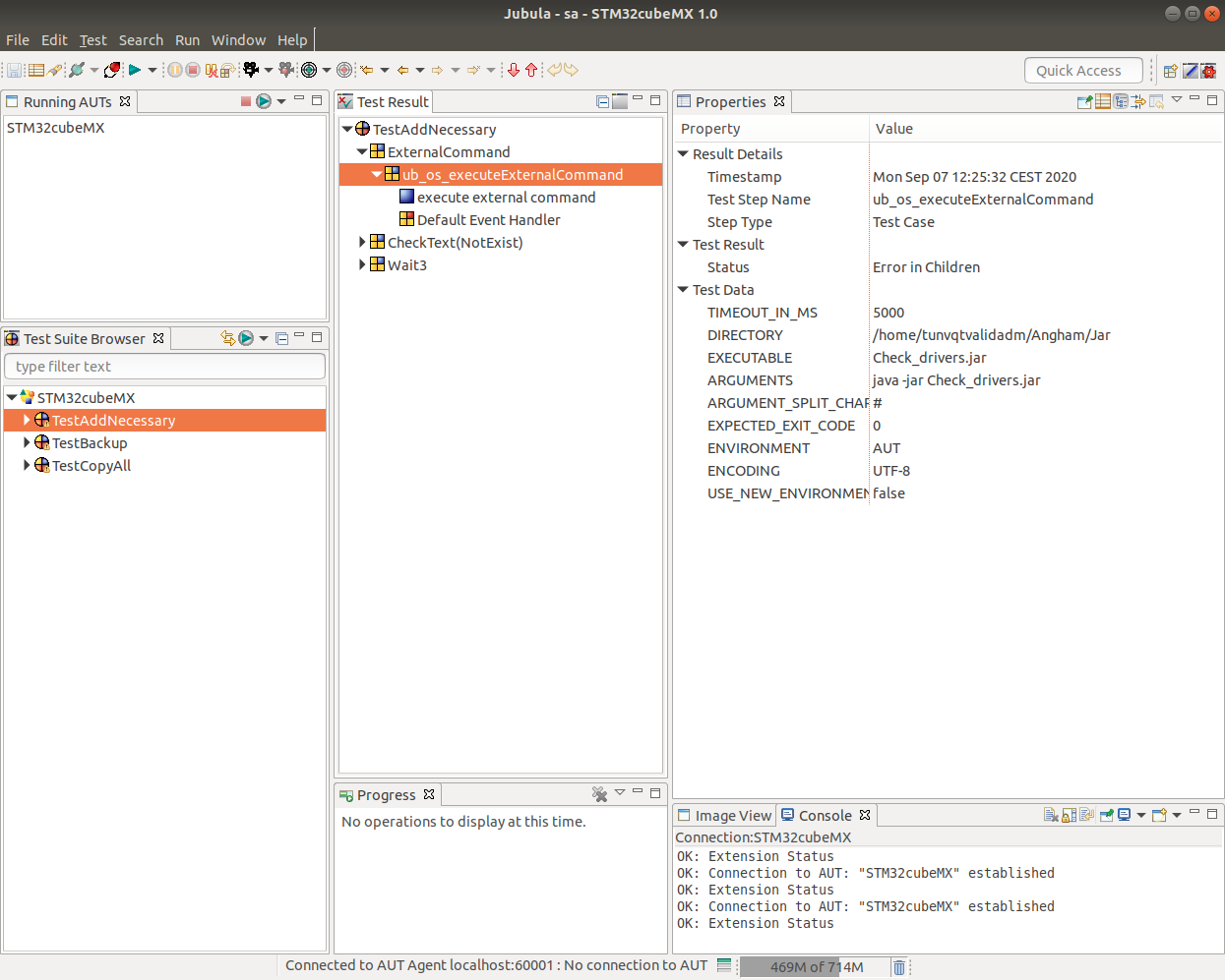

I want to test my project on ubunto but the test was not successful and the error appears in external command despite having changed the directory of the jar file, any help please?

You must use the your java as executable not your jar file.
