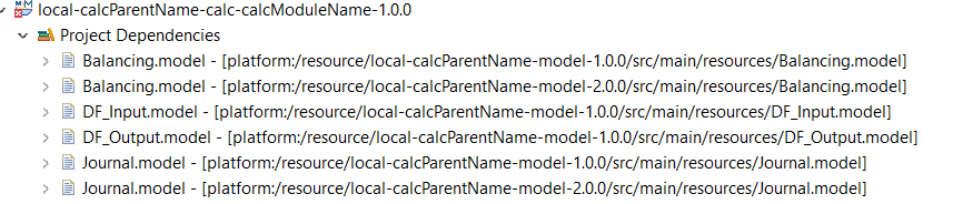

I have two maven projects, local-calcParentName-calc-calcModuleName-1.0.0 and local-calcParentName-model-1.0.0, where the second one is a [maven] dependency of the first one, both having version 1.0.0.
The files used from local-calcParentName-model-1.0.0 in local-calcParentName-calc-calcModuleName-1.0.0 will appear as project dependencies.
Now, when changing the version of the dependency to 2.0.0, I will end up with project dependencies from both versions, as you can see in the attached picture.
So, therefore my question, is there a way to force a refresh/update on those dependencies?
I tried a couple of things, such as removing/adding modeling nature, trying to refresh/resolve the resource set of the current Sirius session, but couldn't find anything.

Hello
If it is only a UI issue, I guess just clicking F5 should refresh properly your tree.
If it is the case and you want to do that programmatically, then you may use the eclipse API to refresh eclipse resources
get the modeling project and then call org.eclipse.core.resources.IResource.refreshLocal(int, IProgressMonitor) (the modeling project is a IResource)
best regards
