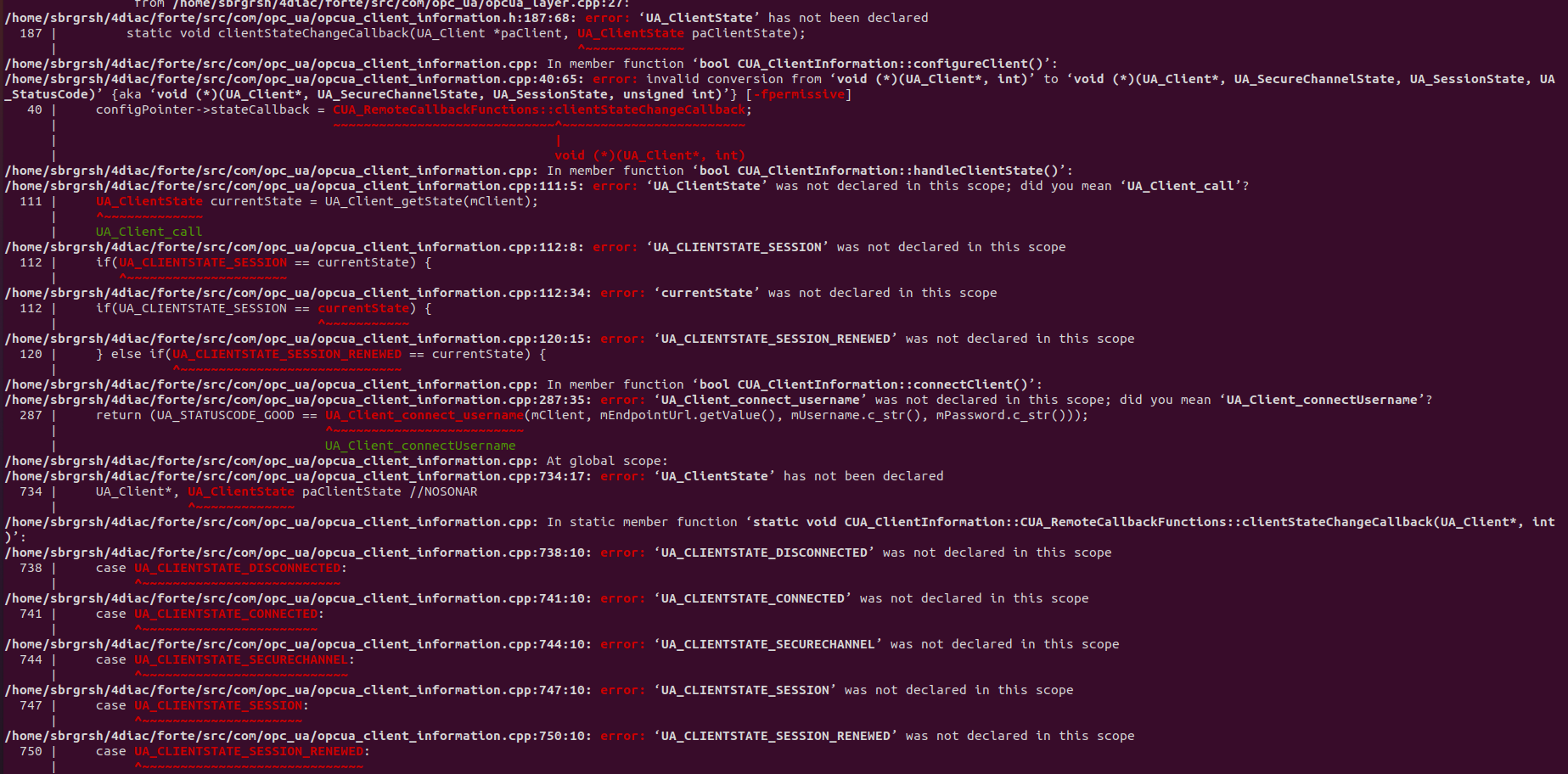

I was trying to use OPC UA from linux using the instructions given in https://www.eclipse.org/4diac/documentation/html/communication/opc_ua.html#subscriptions ,but in the last step , I am getting these error and consecutively forte executable not generated.
make[2]: *** [src/CMakeFiles/FORTE_LITE.dir/build.make:5984: src/CMakeFiles/FORTE_LITE.dir/com/opc_ua/opcua_handler_abstract.cpp.o] Error 1
make[2]: *** [src/CMakeFiles/FORTE_LITE.dir/build.make:5997: src/CMakeFiles/FORTE_LITE.dir/com/opc_ua/opcua_client_information.cpp.o] Error 1
make[2]: *** [src/CMakeFiles/FORTE_LITE.dir/build.make:5945: src/CMakeFiles/FORTE_LITE.dir/com/opc_ua/opcua_local_handler.cpp.o] Error 1
make[1]: *** [CMakeFiles/Makefile2:2176: src/CMakeFiles/FORTE_LITE.dir/all] Error 2
make: *** [Makefile:149: all] Error 2

Re: Error while trying to create Forte for OPC UA [message #1831445 is a reply to message #1831429] Wed, 19 August 2020 22:35 Go to previous messageGo to next message
make sure you're using version v1.0 of open62541
Re: Error while trying to create Forte for OPC UA [message #1831453 is a reply to message #1831445] Thu, 20 August 2020 03:51 Go to previous messageGo to next message
Even after using version 1.0 , i am getting the same error.

Re: Error while trying to create Forte for OPC UA [message #1831457 is a reply to message #1831453] Thu, 20 August 2020 04:53 Go to previous messageGo to next message
You're right, the cmake command is missing the two dots at the end.
The last version of OPCUA documentation is actually in this link https://www.eclipse.org/4diac/en_help.php?helppage=html/communication/opc_ua_version1.html
You really need to make sure you compiled open62541 using the v1.0 tag and not the master or v.1.1. The major changes in v1.1 are in the client states actually, so it's very probable that you are not using v1.0
Re: Error while trying to create Forte for OPC UA [message #1831464 is a reply to message #1831457] Thu, 20 August 2020 06:46 Go to previous message
I am able to get forte executable after using version v1.0.
Thank you for your help
