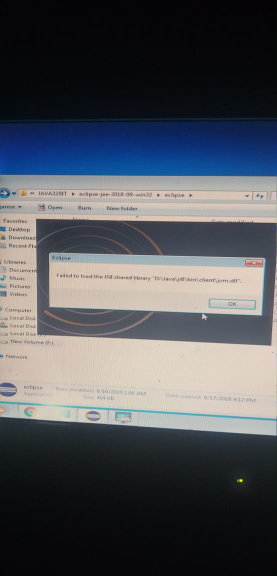

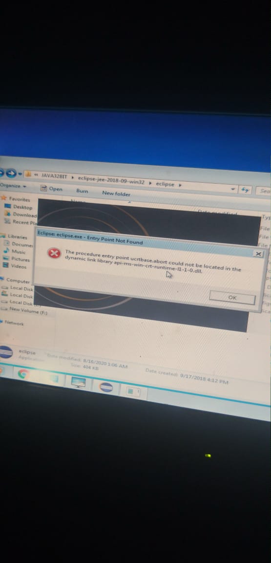

Eclipse ide 32 bit . i can't install in windows 7 32 bit
