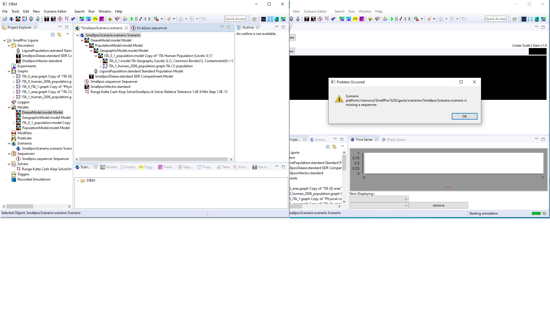

I'm not using the Mac version because it's just not working for me, I'm using a Windows PC.
Where can I find the demos to try out? I've also followed the wiki page to a tee as well and it's not making any difference.
I've attached the image - I think - of the project and the error message i'm getting
index.php/fa/38815/0/
Re: Mac owner, STEM not working on Windows - can someone run a model for me? [message #1831731 is a reply to message #1831629] Thu, 27 August 2020 11:52 Go to previous messageGo to next message
Thomas,
You can find example scenarios here
https://www.eclipse.org/stem/downloads.php#DownloadableScenarios
You might want to join the next community call on Sept 10 to get help and advice. Please register for the STEM-DEV mailing list
Re: Mac owner, STEM not working on Windows - can someone run a model for me? [message #1831734 is a reply to message #1831731] Thu, 27 August 2020 12:00 Go to previous messageGo to next message
Thomas, please also try the latest integration build. Also please post if you are able to run a demo scenario.
What version of Windows and Java are you using?
Re: Mac owner, STEM not working on Windows - can someone run a model for me? [message #1831743 is a reply to message #1831734] Thu, 27 August 2020 17:05 Go to previous messageGo to next message
Thanks for the info so far
I've tried a couple of models - they either crash the application or just don't display any information.
I'm using Windows 10 and Version 8 Update 261
Re: Mac owner, STEM not working on Windows - can someone run a model for me? [message #1831880 is a reply to message #1831743] Tue, 01 September 2020 13:57 Go to previous message
What version of STEM? Have you tried the downloadable scenarios?
Maybe reinstall the latest integration build?
